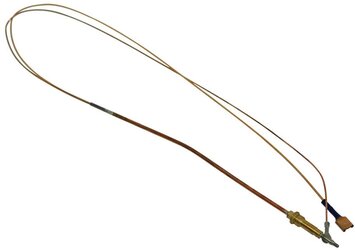

Hi, I was wondering if anyone can help me, I'm trying to work out which two of these three microswitch tabs to use. I have a Hotpoint Hug52 oven and the grill won't stay lit. I checked the thermocouple and it looked in a poor state so I have installed a new one. I took a photo of the wires on this switch but like a dingbat I accidentally deleted it. Basically it has one wire coming from the thermocouple, and one from the front panel controls. The switch is operated by the oven door closing, as the door should not be shut when the grill is in operation. Thanks

Are you sure the original switch was actually faulty? Do you have a multimeter?
Are you sure the problem is not with the thermocouple you replaced, eg the connector mating correctly?

Following on from the above, since you've changed the thermocouple we'll assume you are competent.
As a test, connect the two microswitch leads together (without the microswitch) and insulate that termination.
Try the grill. If it doesn't stay lit you still have a fault somewhere, maybe the thermocouple or a loose connection.

This one is a thermocouple in the flame wired via the microswitch to the solenoid in the gas valve for the grill.
Incidentally axisus, that metalwork/ground tag needs to be well connected to the metalwork that the gas valve is mounted on for this to work. You presumably used the original earthing point?

Thanks all, I have finally worked out that the microswitch is the problem. I bypassed it by connecting the two wires together and the grill works. New microswitch required!
