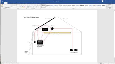

Afternoon all,
Just bought a house with a remote garage, said garage has no power or lighting.
I'm hoping to use the garage as a gym and some storage so I'm looking to install 2x 5ft LED batten lights (45w) along with a wall switch and 2x double wall sockets.
Found this off-grid solar kit and after speaking to the company about my usage they said this kit should be perfect. 600W, 12V, 0.57kWh Deluxe Off-Grid Solar Kit - Sunstore Solar - https://www.sunstore.co.uk/product/600w-12v-0-57kwh-deluxe-off-grid-solar-kit/
What I need help with is everything else I'd need to get the job done, and if anyone can help, maybe a wiring diagram for the load where it connects to the inverter/solar controller?
Any help would be greatly appreciated.
Rich

Really roughly drawn and definitely not to scale!
But this is the plan I have for installation so far.. Do I need to put an RCD in anywhere or have I gone wrong anywhere?
Any helpful comments would be greatly appreciated.

Assuming the output of the inverter is properly protected for overload and short circuit then there would be no point installing addition fuse or mcb protection.
An RCD will only work if one pole of the output of the inverter is connected to earth permanently and reliably. In my opinion for such a small inverter it would be safe enough, if the installation is designed suitably, not to do this and keep it as an electrically seperate system.

Hang on, hang on... but I've just looked up the typical power usage of a treadmill... it's like 1.5kW !
So, throwing some numbers at this... your proposed solution will have an AGM battery rated at 95Ah... giving a usable capacity of about 30Ah, being 360Wh... so assuming that no other power is used... just the treadmill... a fully charged battery will run the treadmill for about 24 minutes...
Adding in the fan (30W), the lights (45W), iPod speakers (10W)... I reckon you'll be lucky to get 20 mins of workout time...
All of this assumes that you're not doing it at midday with the sun blasting those panels of course.
Solution re-think needed I reckon... more AGM batteries ? Lifepo4 ? Portable Lifepo4 solution ?

Ah shoot, sorry mate! I'll base the 1.5kW for the bike instead ;)
I shall be ringing that company again then, and see what they can suggest, as I usually spend 2 hours a night in there. + winter months won't yield as much charge.
Yea looks like I'll be needing the 1200w system:
This then allows for a max peak draw of 1200w so I could install electric garage door If I choose to to run through the system as well - but only if I do away with the exercise bike - which I think I will now consider keeping in the house to make life easier & cheaper.

You seem to have missed out the 600W output of the inverter in your calculations, so actually it won't run a 1.5kW load at all, it will trip out on overload (hopefully, or burn out if not)

A garage door opener usually only draws a small amount of power and won't be a problem as long as it isn't operating at the same time as something that uses a lot of power.
When working out how much power you need you shouldn't just add up everything you will use, you need to consider what will be using power at the same time and what will be using power seperately. You aren't going to have the garage door moving whilst both exercise machines are running, the heater is on and the fan is on!
Thanks davesparks,
That has actually helped my understanding a little more. I'm now feeling even more confident about installing the kit from having theses discussions.
