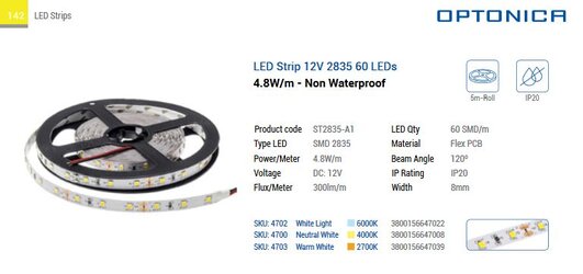

Model name is Optonica LED Strip 12V 2835 60 LEDs SKU:4703
I manage to find them in catalog and I made a screen shot so you don't have to bother searching for it.
I'll post it so you can see specifications.
TL;DR
Does my model of LED strips produce ANY UV at all?
