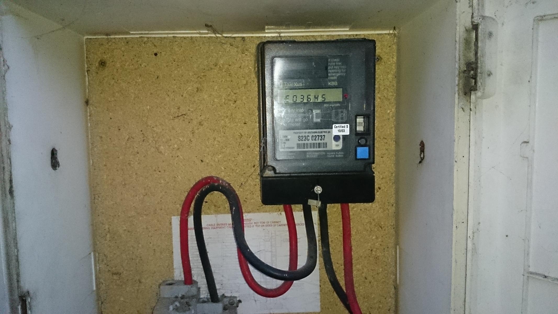

Hi Engineer54. The first few posts were along the lines of a quiz, so I was trying to get people guessing. Perhaps it's so obvious it isn't worth asking, in which case I'll go now! I'm no electrician, but have been told what the system is by the DNO. It's fairly unusual and outdated as far as I know, and I thought people might be interested (as the thread suggested). I have more pics, I was waiting to see if folk needed more. I was ultimately going to ask this question which I don't know the answer to: how safe is it and what can I do to make it safer!
i'd like to see it with the red insulation tape removed.
Hi folks. yes, intermediate pole with earthing. Didn't mean to mislead anyone. The red tape isn't masking anything, it was covering the exposed copper at the meter tails. I'm guessing that the greenish wire to right of main fuse is the earth. I am trying to post more pics, but have just upgraded machine to Windows 8 and am lost!
