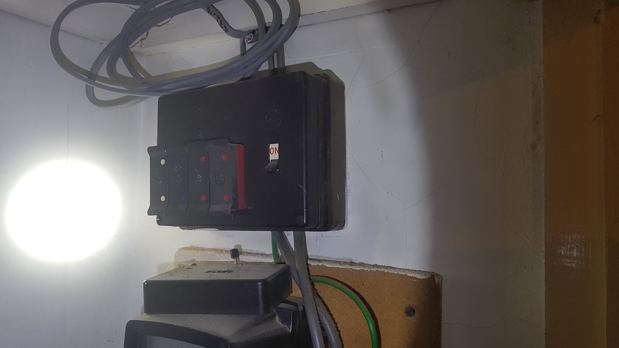

Bear in mind that registration with a scheme, such as NAPIT or NICEIC is absolutely no guarantee of competency.
These according to the NICEIC registered sparky who done the Eicr are 60898 type B MCB's And the RCD is 30ma and has a trip time of 28ms x1 and 19ms x5

And i wouldnt recommend a NICEIC registered electrician after what i saw and the fact they are not interested in following it up

And yes i have tried to report him but do you think the NICEIC are at all bothered...not a bit
Well if the NICEIC are not interested elevate it to UKAS and their complaints procedure Complaints, Feedback and Appeals - UKAS - https://www.ukas.com/customer-area/complaints-feedback-and-appeals/
