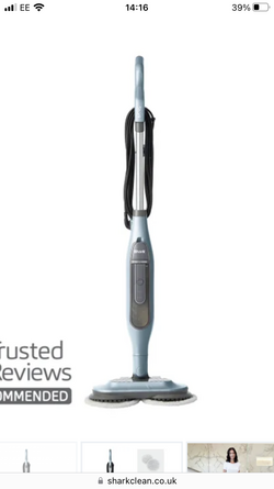

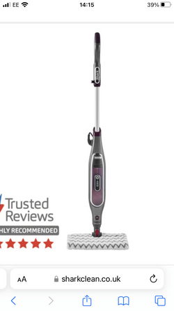

Hello,
I would like electrical advice please. I recently started a new cleaning job. I have been asked to use a Shark Steamer. The floor I am cleaning is huge. Unfortunately the steam is not sufficient enough to clean the big space. The owner has asked me to chuck water on the floor to help the steamer to get rid of the dirt. This works beautifully, BUT the electrical cable that is attached to the steamer gets quite wet from the water on the floor. I have always been told that electricity and water don’t mix, and I feel worried that this could be dangerous. I don’t want to be electrocuted! I appreciate your help with this. Thank you in advance.

A steam cleaner in itself mixes electricity with water, so small puddles and moisture are expected…. But not great pools.
I don’t know if you can get a battery powered steam cleaner…. But you might need several battery’s to swap out if it’s a really big area.
If you continue using a cleaner with a cable laying in water…. Make it as safe as possible.
Have your machines tested (PAT) and get yourself an RCD plug in adaptor… and make sure you test it via the button before use each time.
The property may itself have rcd protection for the socket you are plugged into, but you would need to trust that it works as it should.
Are you using an extension lead with it?

Thank you very much for your detailed reply. I might have to speak to the owners, as I don’t feel comfortable.

Hi Little Spark, Thank you for your help. I have spoken to the lady I clean for. She doesn’t seem worried, she said it would only cause a problem if the cable was frayed and water would get onto the cable. I have no idea if this is true! She also explained to me that they have an ‘electric shock’ system. But like you say I need to trust that it works like it should be. Frankly I am still feeling worried. Obviously throwing tons of water on the floor is not how the steamer should be used! I am thinking of buying a RCD plug, I hadn’t heard of them until you mentioned them. Just to clarify I would need to test the steamer before each use? How long would this test roughly take? It’s something I will have to mention to the lady I work for. Thank you so much for being so helpful.
One of these….
https://www.NoLinkingToThis/p/masterplug-13a-fused-plug-through-active-rcd-adaptor/63731
Press the “test” button before each use…. It simulates a fault and will trip off the power to the appliance. Pressing reset will, obviously, turn power back on.
It doesn’t actually test the appliance in any way, but simply turns off if it detects a fault.
