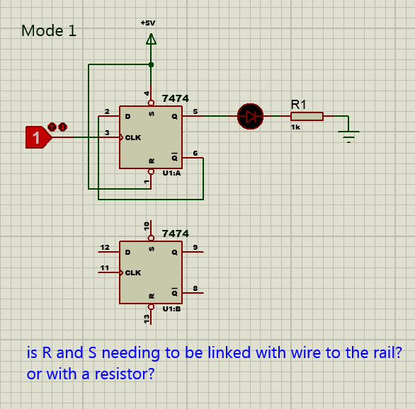

What is the role of the Set pin (4&10) on the 7474 chip? Besides setting or inverse of a reset.
Is it an input? If it is, then I believe it should be linked to + or -. To avoid random triggering. Right?
I believe I RE-solved the circuit problem and make it even smaller than it was and even better in functionality.
This is the new and improved cct !
All those INPUTS (S) representing the SET pin of the FF, are now linked to + rail, directly. This result comes from testing in reality. I was still having problems on the last (4th) FF on the CLK pin, with that bouncing button. But I believe, NOW when all these inputs are set to High, and not floating anymore, might affect the good functionality of the FFs. I think I am right... what you say?

Unused input and control pins should never be left floating to avoid spurious operation of the logic circuits.
Thank you.
Indeed. I remembered it way too late. I did mentioned that Im still learning the logic ICs, right? So the very big mistake I did was to Not convert properly the original cct into my ICs that I have ! But is a lesson for me. I spent 2 days on it. I think....
