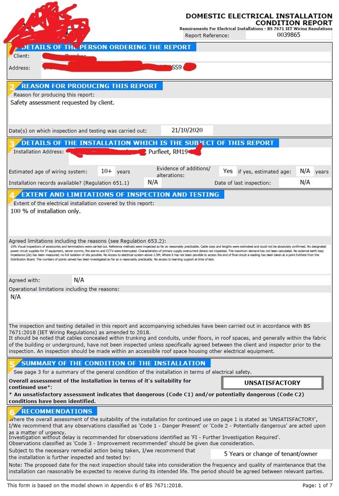

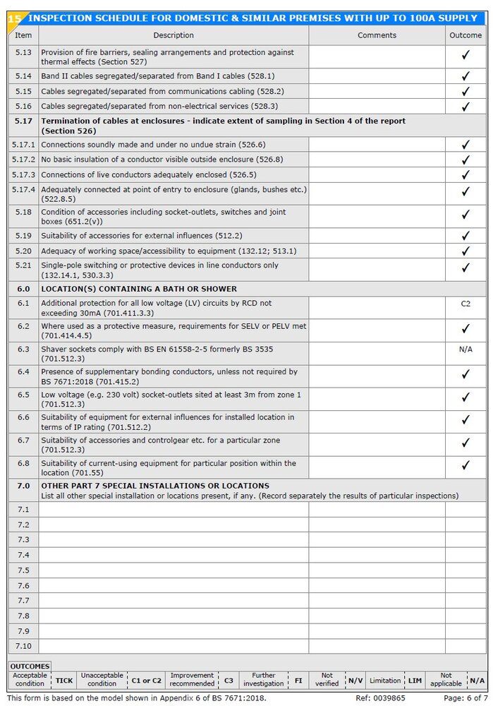

I wonder if any electricians can offer some advice? I feel that I may be getting taken for a ride. I rent out a 2 bedroom flat built in 2005 that has just needed an EICR. The letting agents have managed this for me and the report has come back as failed with a draft quote to pass the EICR that consists of a new consumer unit and other bits for £1173.60!

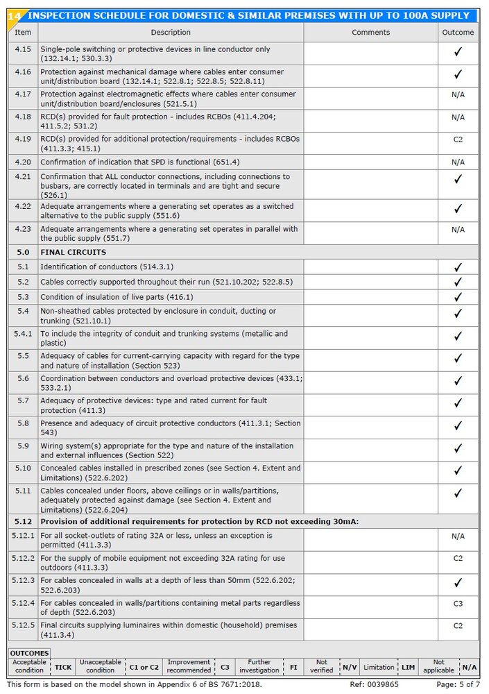

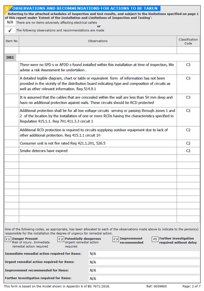

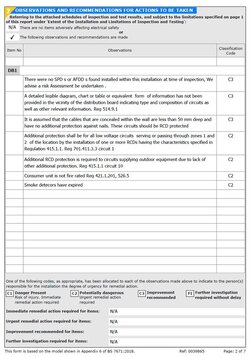

My main concerns in the report are that I have the following C2's.
A) Additional RCD protection is required for circuits supplying outdoor equipment...
The main sockets are on RCD protection, but it's a 3rd floor flat. I can't see why outdoor equipment would be mentioned?
B) Consumer unit is not fire rated...
Looking at the report it is a C2 on the Observations page, but on the Inspection schedule page, it's a C3. Could it be both?

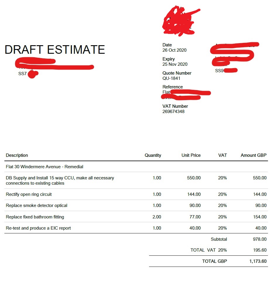

Additionally to the C2's above, they are charging me to fix an open circuit on the earth, would they not have tested all the sockets on the test and fixed them, if required, as they went along?
I have also wondered what 'Replace fixed bathroom fittings' at £154+vat would be, any ideas?.
I have gone back to letting agent to pass my questions and concerns over to the electrical company and they have just responded with the following:
We have reviewed the EICR again and stand by what we have advised, the parts where the LL suggested the work doesn't need doing due to the regs is a really grey area, it depends on the engineer as to whether they would recommend the works or not - and rather we say they do not need work and an issue were to arise, that would leave us liable for not recommending these works be completed.
We might be airing on the side of caution, but we would rather be safe than sorry.
Is this a fair response, and not to answer my questions above? Does the report and draft quote look fair? EICR has already cost me £200.

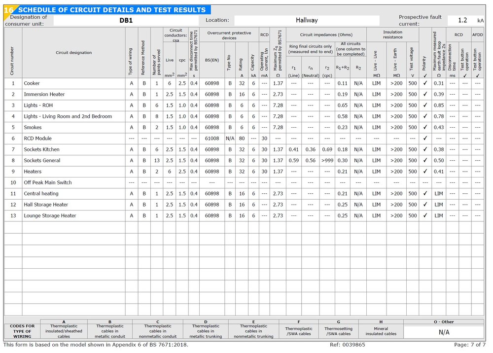

There are still details of the tester on the General Condition Of The Installation form. Including address.

The testing company hasn't been blanked either :)
Hi - when doing a Report there is no obligation to fix issues, but I certainly would’ve fixed a loose earth wire as part of confirming all terminations are sound. However, if the fault wasn’t there in front of me I would record Further Investigation code and move on.
I have seen where a Report bigs up an issue and then quotes big to fix it. So I would get an independent Electrician to quote for repairs. Many good Electricians here would be happy to help if you need a quote.
Bathroom lights might not be IP rated for use in there, so fair enough if true. A plastic CU in good condition is normally C3.

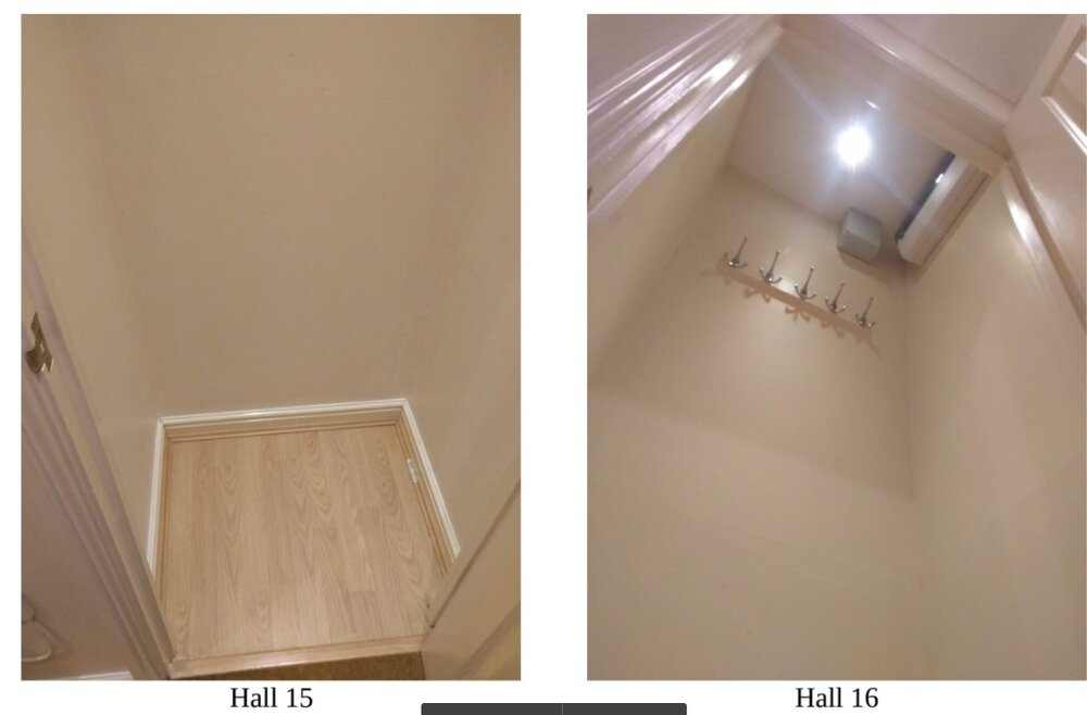

The consumer unit is not in the Hallway as mentioned in the report. It is in a small storage area with a fire door at the front of the property high up near the ceiling. Pictures attached - thanks.

With the rcd off check to see if all sockets are dead. Use a small appliance like a hair dryer to verify.

However on the test results sheets there's no mention of RCD tests carried out.
Additional protection for the bathroom would normally attract a C3 if there's supplementary bonding in place. Without seeing the installation I can't comment fully.
Additional protection for outdoor equipment is not applicable as it is a third floor flat, no code.

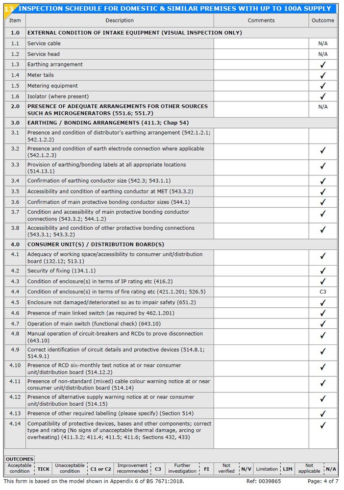

Consumer unit not fire rated is not even a code, it should be made of non-combustible material however as it is located in a cupboard away from an escape route it would only attract a C3.
Smoke detectors are not part of the installation and shouldn't be coded, they should receive a comment advising they're replaced, they do not fall under BS7671.
They haven't even coded the discontinuous conductor on the ring final circuit yet have quoted for investigation and rectification? At my normal call out rate and hourly charge that's four hours to find a broken CPC in a flat? They're taking the Mickey.
I’m not a big criticiser of other people reports, but...
C2 for plastic board -wrong Should be C3 or no code.
C2 For out of date smokes - wrong Should be no code. Smokes are not part of our regs. Only the hard wired connections and electrical safety are what we are establishing. Yes it’s worth a mention but that’s all.
C2 for no RCD for circuit passing through room containing bath or shower. wrong unless there is no supplementary bonding present. This was not mentioned therefore we cannot judge.
C2 for sockets that may be used for outdoor equipment. Correct, but as you said it has RCD protection.
something isn’t right with this one. Get a second opinion.
Yet suitable IP rating for location gets a big old tick in the schedule of inspections.
As others have said, a number of irregularities between the inspections and test results. Second opinion required I think, or at least ask for quotes from other electricians and supply them with this report.

No sign of the supply characteristics, earthing arrangements or particulars at origin, either....might tell a tale or two.
I think @westward10 removed that page because it had the inspectors name and signature on it still. It was there earlier.

Supplementary bonding is ticked as ok

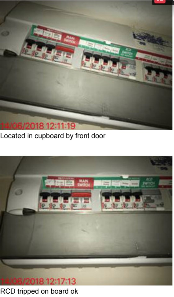

Yes, almost certain that both kitchen and general ring mains are on RCD. I also have a report from 2018 that tested the socket for tripping in the hallway. The CU picture is a little blurry but does match up to the new report and shows both sockets within the RCD block.
That looks like a LeGrand/Tenby board, which appears to have been the go to for Barratt flats around that era and maybe other builders.
I've done several EICRs on them and found issues, but nothing that's required a new consumer unit yet (apart from a recent one where it was manky and the place was being refurbed). You can still buy parts for them for one thing, but unless they are severely damaged they are usually still very servicable.
This looks very similar to one I looked at in Southend earlier this year - a dual tariff board with the off peak side storage heaters and immersion non-rcd protected. There is probably a consumer unit somewhere in an external communal cupboard, with 16mm T&E to the board, protected by MCBs.
If it's as I think, then the C2 for additional RCD protection (which mentions Circuit 10), is for the off peak side, and there will be no socket outlets on there, so no opportunity to supply outdoor equipment and therefore not a C2 even if it wasn't a 3rd floor flat. (Assuming someone hasn't added a socket somewhere)
The C2 for fire rating is bogus - I don't think even NAPIT codebreakers (which is known for being 'strict') goes that far and the other guidance definitely does not. C3 at most unless there are signs of heat damage.
The flat I checked did have supplementary bonding in place, in which case the other C2 would also be irrelevant. (As mentioned, it is also ticked in the schedule in this case)
As also already mentioned, the smoke detectors expiry is a point of comment but not a code.
The tick boxes on the form are rather randomly ticked, including for inappropriate things like switched alternative to the public supply.
The fact that no RCD disconnection times are stated is also concerning - either the RCD failed, in which case it would obviously be noted as a departure by itself, or they forgot to make a note of them...
Regarding the quote:
The DB supply and install price is actually not too awful, *if* they were quoting for RCBOs for every circuit - though I wonder if they've factored in the off peak circuits in that too.
The price for replacing an optical smoke detector seems extravagant, especially if they are already there doing other work.
My guess is that the bathroom fittings may be for the downlights in the bathroom, which are probably badly connected with single insulation visible and may not be not bathroom rated ones, though they may well be outside the zones anyway. If this is so, they should have noted those as a code really and they've ticked the schedule to say it's fine.
So overall - based on the quality of their EICR I'd definitely think twice about going ahead with that quote. How can you be sure they'd properly test and certificate the new CU install, based on the issues with this certificate?
I'm the other side of the river, but only 20 minutes or so on a good day from it, so if you want me to give you a quote PM me. I can't promise it will pass first time, but I can guarantee that any remedial works would be suitably justified.
Just spotted another issue too - circuit 9 "heaters" is on a 32A in 2.5mm, but not tested for ring continuity.
The flat I checked did have a ring for the heaters, so I bet they forgot to test it.
The amount of mistakes on the report brings the testers competency into dispute . I would get it retested by someone on this forum and refuse to pay the bill for the original EICR .
90 % sure it would be a satisfactory report if i had carried out the EICR .
We've all made silly mistakes when doing a certificate late at night, but given the number on this report, it would be pulled apart in court were something to happen - or even if the local authority requested a copy and someone who knew what they were doing looked at it.
