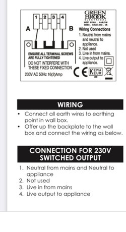

Okay so I bought the “Greenbrook 24 Hour Mechanical Socket Box Timer 16A Resistive 2A Inductive” from tool station… the instructions have the two neutrals together and then the 2 lives in different sections… if I just run a 3 core so I get the additional neutral I will still be without the additional live? Is that not needed?

with that timer, yes, you need a live, neutral and switched live to make it work.
If it’s only a twin and earth running from junction box to switch, you’ll need to replace with a 3 core and earth

Perfect thanks for your help! Very tempted to just get a smart one that only needs the two wires I currently have to save the faff
