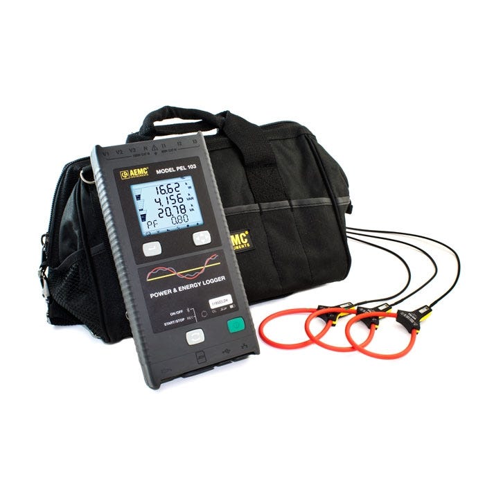

Does anyone have a suggestion for an affordable voltage monitoring kit that can be used to monitor the incoming supply over a period of time? that will not interfere with any other CT device on the incoming supply.
Have a chat with Test Meter (they are/were sponsors on here and are thoroughly nice people) about renting the right bit of kit for a while, although you might have to enlist a local sparks to help you set it up properly.
