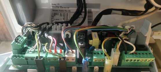

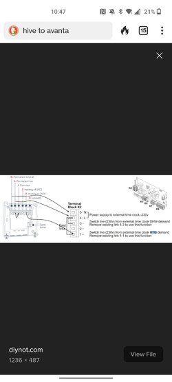

Hi.
As per header. I just want to make sure I do this correctly.
Remove old wires from X9 7 and 8 and link these two (from another thread on here. Is this correct?)
X2: remove link between 1 and 4.
Hive neutral to 5,
Hive live to 4,
Hive 3 (live switch) to X2 1
Do I need to link L and 1 on the Hive plate?
Photo is of current set up plumbed into a honeywell thermostat.
Thanks in advance!
Dean.
