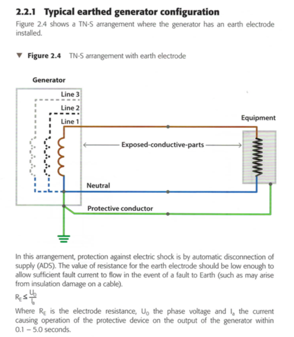

Hi everyone, I live well off grid in Wales and am presently renovating a small property. As part of that renovation I have had a full off grid solar system professionally fitted coupled with a generator back up.
The inverter charger has a neutral earth link as does the generator. The inverter charger has a ground relay so that if the generator starts then the inverter charger disconnects its neutral earth link and the generator neutral earth link comes in to play. The system is earthed by two, 2.4m earth rods placed 3m apart driven in to the forest floor. The solar installation is 120m away from the property it supplies and a 3 core, 25mm, SWA cable takes the supply from the solar installation up to the property.
My question concerns the earthing arrangement at the property 120m away. I'm categorising the solar installation as a TN-S system - your thoughts?
As the supply cable to the property is 3 core can I use the third core as my sole earth or should I be sinking earth rods at the property end and creating a TT arrangement?
I've had quite conflicting opinions, professional opinions, thus far and would really appreciate a solid and logical answer.

IIt all should be TT and should be protected so. There are experts here that will tell you what the value of the rod should be for a stand alone system.
Thanks Bill, that’s what I’ve done in the end. I knew I could go TT, but not ever so familiar with off grid I wondered if there was a better way. I’ve got the Ze down to just below 100 ohms at the property with a couple of 2.4m rods and trips/operating times of my RCBO’s are all good and well in limits.

I don't know for sure, but why must this be TT ??
Surely this is the same as how we set up generators to be TN-S for live events all the time?
If you have 3 conductors going from the generator and solar already why not use one for the earth, this is a much better, more reliable and lower impedance connection rather than relying on the ground and soil to connect your earth to the generators neutral
If it was set up as TN-S and the generator still has an earth electrode this is not in any way a TT system as the generator earth electrode is only used to reference its neutral to ground (much like the electrode at substations), for example the system would work perfectly well without any electrodes and in which case would be an IS system, although this is not recommended due to fortuitous earthing present risk that might not have been considered
As far as I know you are completely allowed to set up your own TNS system and I would favour it over TT, the only thing you are not allowed to do is set up your own TNCS system under the electricity safety, quality and continuity regulations

Thanks Marcus - much appreciated. Everything you say makes sense to me and was part of the dilemma that I was having.

I guess the upshot is that the scenario and decision is mine and so I’ve gone TT.

Iv attached some pictures of the earthing arrangments I have mentioned, etc just for a bit of information

I’m of the thought that more rods = more good.
The cable that links the generating facilities will need to have a CPC and I’d be using this at the house and adding more rods at that end. All the rod installation locations should be sufficient by themselves to satisfy loop disconnect but I parallel them to increase reliability. This would seem to be “TNS supply with local rod support”.
Thanks Wilko. The 3rd/earth core is earthed at the generator end incl a cpc link to the sheath. At the property end it is capped off in its own Henley block and no cpc link to the sheath to keep the two entities separate.
TT is the direction I’ve gone in and now that I have I’m having a little ‘play’. I’ve got 2 x 2.4m rods paralleled at the solar/generator site. I put 1 x 2.4m rod in at my property (120m away) and got a Ze of 146 ohms. I paralleled that with a second 2.4m rod 3m away which dropped the Ze to 100. The ground at the property is s as mixture of clay ‘topsoil’ descending into shale.
Id like to drop the Ze below 100 now to cope with summers dryer ground later so I’m going to place another parallel rod. I’m expecting to get another 30ish ohms drop.
