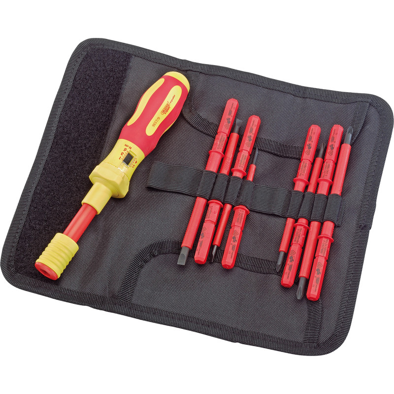

I am having more dealings with western power. In turn, they are now fitting series 8 cut outs and generally an isolator. Both of these have hex key screws. I am not comfortable using my uninsulated set.
I have a draper torque screwdriver and it would be great if they do some hex key's that fit this, but I can't find any. Does anyone know if they do them that specifically fit the torque screwdriver.
Alternatively would anyone recommend a set of insulated hex key's, not the standard L shaped ones, but ones with a handle?

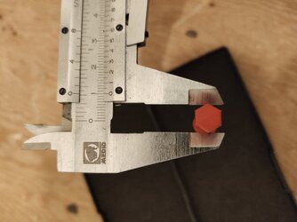

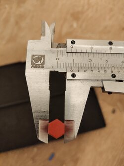

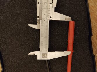

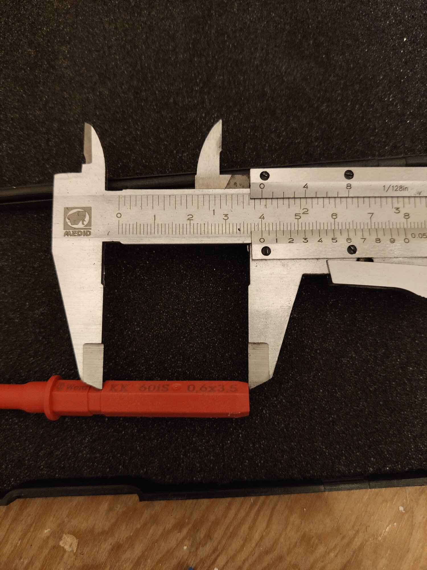

If you can post some measurements of the bit that slots in we can check against my wera set and see if they can be interchangable.
I'll post some pics tomorrow
I like it. Much cheaper than the Wiha torque. I cant's compare it to the wiha though as I don't have those.
It feels like good quality, the bits stay locked in place and the bits fit into the screws firmly, that's about all you need really.
The bits measure 9mm, although that's just me measuring them.
Here is a link to the ergo-plus rangehttps://www.drapertools.com/category-products/8381/VDE-Screwdrivers-965-ERGO-PLUS-Range
But.... thinking about it, I would have gone with the wiha torque, simply because they have a wider range and I wouldn't be in the predicament I am in now.

Those are the sizes of the wera set,
@happyhippydad can you check against your draper kit?

Just seen this post @kropaske . Really kind of you to go to the trouble of doing all that work.
I have just measured the draper ones and the Wera will not fit. I'll write your measurements down just in case I am not seeing them correctly as I have noticed a picture can distort things a bit
Your measurements (Wera).
Picture 1 = 51mm
Picture 2 = 7mm
Picture 3 = 6mm
Picture 4 = 37mm
Draper
Picture 1 = 51mm
Picture 2 = 10mm
Picture 3 = 9mm
Picture 4 = 33mm
I've just bought the Slimline Wiha, they seem perfect!
Draper
Picture 1 = 51mm
Picture 2 = 10mm
Picture 3 = 9mm
Picture 4 = 33mm
Thanks for those. It wood seem that picture get distorted. Wera measurements are exactly the same as draper except last one. Draper 33mm, wera 40mm. So it looks like wera will fit but may not lock.
