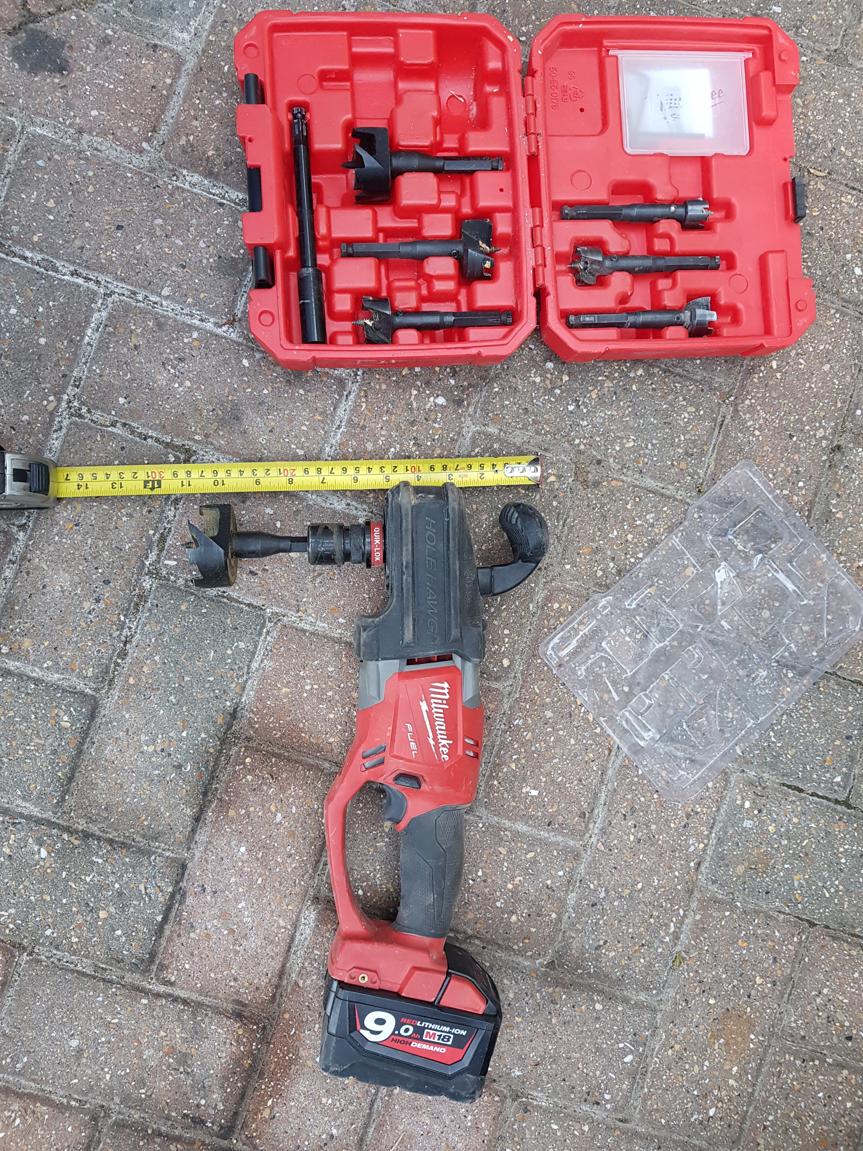

Cheers. Which drill bits do you use?
Mine came with a free set of the milwaukee bits. These ones, they have replaceable blades. They literally chew through anything. The bits come with an extension rod which has proved very useful.

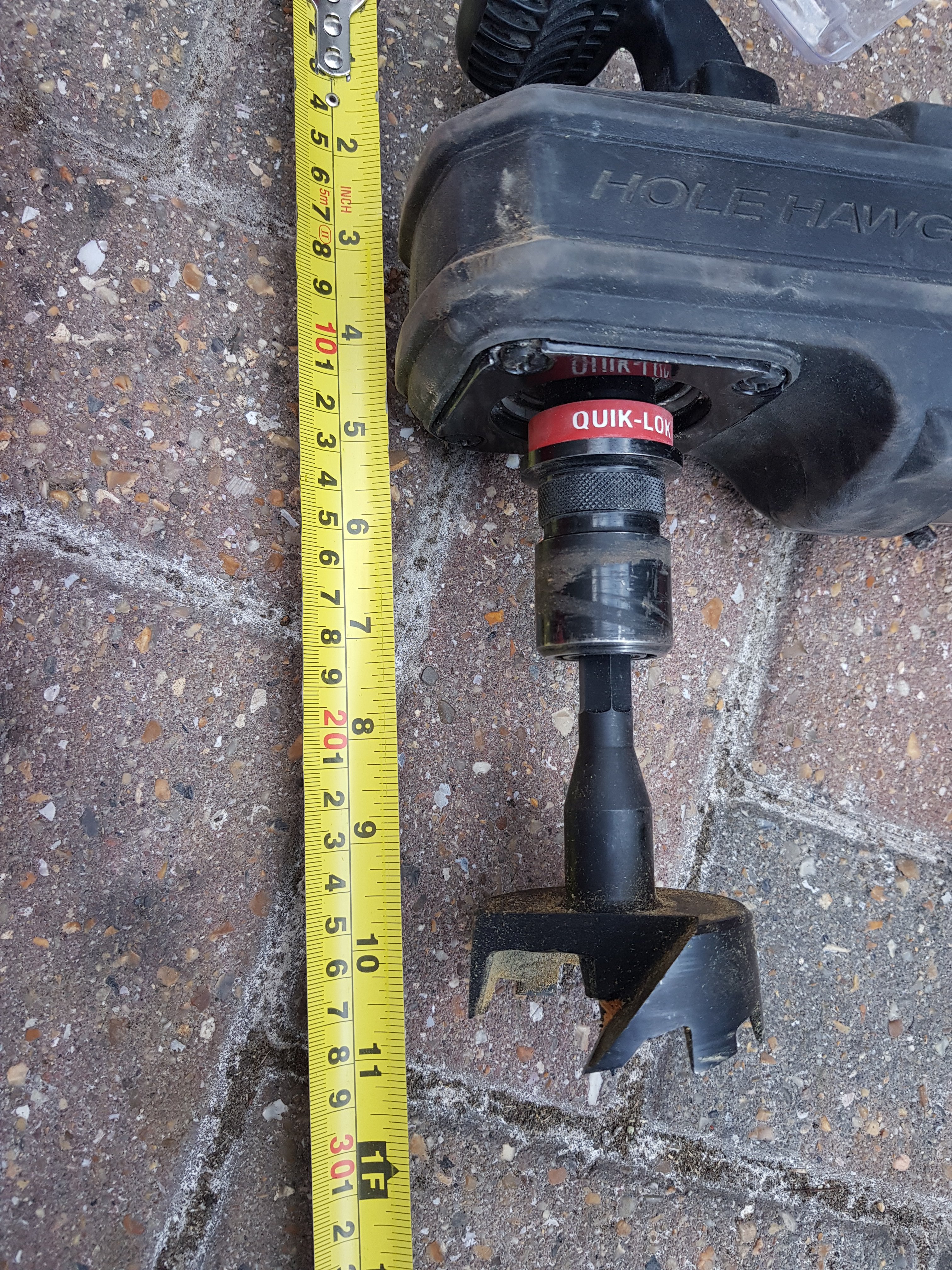

Have you got the super hawg or standard?
This is my Hole Hawg with Quik Chuck. Takes 11mm hex bits. 10.5" with handle. Bit set is Contractors Selfeed bit set 7 piece.
