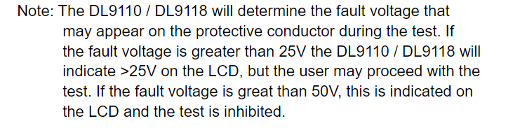

Test instruments meeting the requirements of BS EN 61557 must perform a pre-check when testing to ensure that the earth potential does not rise to a dangerous level during the test. This will apply to earth loop impedance testing and RCD testing since these tests involve producing a current on the earth. If the test current is expected to produce a dangerous voltage, the tester should inhibit the test and show a warning, such as >50 V.
It's a Dilog 9110 (can't afford anything premium right now lol) it's ok but prone to being temperamental.
Nowt wrong with that.
This is where the devil is in the detail:
(On some other makes that message can mean something else.)

Seeing >50V warning to me sounds like the earth/CPC is exceptionally poor the test current is pushing it up above 50V.
Have you tried a new set of probes?
I have the 9118 and it is fine (though I question the no-trip accuracy in some low Zs cases) and so far not seen the 50V warning. Probes are "consumables" as eventually the flexing breaks the conductors or the plugs get weak and don't establish as good connection.
