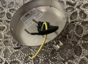

I do basic electrical DIY like changing light fittings and have got a light to put up that only has a fly earth and no flex earth (see pic).
I’ll be buying a junction box but just wondering why I’ve no flex earth?
Do I just use the fly in the junction box alone?
TIA
Yes that is the earth.
