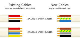

I think you need to elaborate as you aren't making much sense. The conductors you describe can serve any purpose providing they are correctly identified.
Red Blue and Black are old DC supply colours. What is the cable used for? As above any colour could be used for any purpose.
In some older buildings where there was 3 phase supplies serving single phase loads, and the installation was singles in conduit…. The phase colours were used.
So normally where you would see red, black and g/y, you could have yellow, black, g/y or blue, black, g/y
If metal conduit, there may be no green/yellow…
What is the situation you have found?
BTW, @buzzlightyear why is your diagram showing the cores in the wrong order? Old 3 core and earth is red, yellow, blue…. And your new cables on the right are similarly mixed up…. Should be brown, black, grey.
I’m not 100% certain the cpcs are in the right place either.
6 Changes to cable core colour identification​
Table 7B – Cable to BS 6004 (flat cable with bare cpc)​
Cable typeOld core coloursNew core colours
Single-core + bare cpcRed or blackBrown or blue
Two-core + bare cpcRed, blackBrown, blue
Alt. Two-core + bare cpcRed, redBrown, brown
Three-core + bare cpcRed, yellow, blueBrown, black, grey
