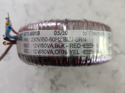

If you don't fancy the 379 euro's of the Becker unit, you might be able to find a transformer with the right output, but it will be physically different, probably be a toroid, and so the pcb would need fettling!
You need a mains to 22V (or 24V?) transformer rated at about 160VA, or 160W(ish) if you prefer!
There are toroidal transformers around with 22V windings.
or
Toroidal Transformer 160VA 2 x 22v 3.63A VDE 0570 / EN 61588 Type 160.22 | eBay - https://www.ebay.co.uk/itm/374893634188 (secondaries in parallel?)
or the option of 24V (secondaries in series)
