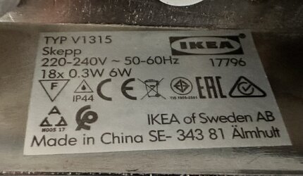

1 out of 3 electricians told that 0.75 has to be replaced : Short 0.75mm flex cable used as fixed for one led light, 1 90 bend, 1 m long. Sorry reposting in DIY section, because I’m being moderated in pro section. Only posting there because I don’t get many replies in here. Regular CU with 2 RCDs and breakers etc.

The label on the box says to connect the primary side with 0.75mm so, you're following manufacturers instructions there.

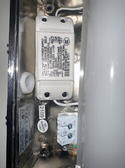

you are right , I just noticed. Or maybe it is just saying 0.75 about the wires that coming to the driver, because the actual connector including ground a bit further
Does it mean manufacturer instructions override UK regulations?) or is it just a bit of grey area we stumble upon ?

the wiring inside the light fitting from led driver to connector is 0.75mm, so no matter what I put as a fixed wire afterwards, this 10cm of wire will melt first, wouldn't it?
