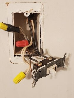

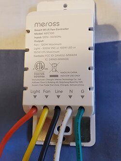

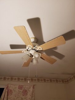

WIRING FOR WALL SMART SWITCH FOR CEILING FAN/LIGHT
Just bought a smart wall switch for a ceiling fan/light currently connected to a single switch, fan has pull chains. Pretty sure I know the wires connected to the wall switch, not my first rodeo, but just want to make sure so I don’t blow the smart switch. Pics attd of exisiting single switch wiring and also smart switch wiring.
So four wires coming into top of box, two white pigtailed together(bottom two in pic, neutrals?), two black connected to switch(pwr into/out to fan?). Then two wires(pigtailed top of pic w/black tape), one white, one black sprayed white, coming from bottom hole of box.
Any/all help appreciated, thanks SO much! Tom
