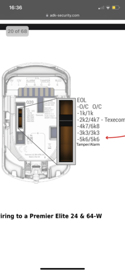

I’ve tried wiring like this but when I do a walk test it won’t pick up the pir as zone 1, I’ve linked across the tamper in the control panel and only connected to the zones and + and -
So you have connected as per pic and reinsert link to tamper terminals at the panel and it behave same as with your original connection?

Yes I wired it like that and linked between pir tamper terminals on panel and it’s still not picking up when set, it’s like it recognises the movement as the light comes on the pir but it’s not setting the alarm off, I suppose it could be a damaged wire but there’s power to the pir
Forgot to say earlier but EOL values will need to be programm.
Also before you do that it may be worth to restore factory defaults, incase you have change something else accidentally.
Thanks very much, I’ve just had a search into it and by the looks of it you can’t programme the value of the eol resistors into the lcd keypad I’ve got, so I may need to go back and try the original tamper wiring, would you know which setting this is on the back of the pir by any chance? I can then wire it in not using eol and hopefully this will work
