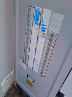

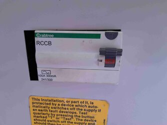

Opinions on this Crabtree TP 10 way board? Got to test this next week after a quick recce on a clients site yesterday. Although probably electrically safe the RCCB is feeding everything including another board Fed via an SWA and some external services also in armoured to. Thing that bothers me the most is if the RCCB trips either due to a fault or a nuisance trip the access gate is effectively powered down as is the fire alarm. I have 2391 but new to a company who do more in depth industrial testing.
In my mind I'd either suggest this Is completely replaced or modify with a Schneider bus bar conversion kit (I used to fit these a few years ago in mobile coms base stations - available from Edmundson's) is used and all the existing MCBs are replaced with MCBs or RCBOs depending on what they're supplying. Nice little gap near the RCCB.
Any codes you'd give this. Just looking at it this?
Don't worry about the fire alarm going off, should have battery back up. The gate you may able to power off when it is open.

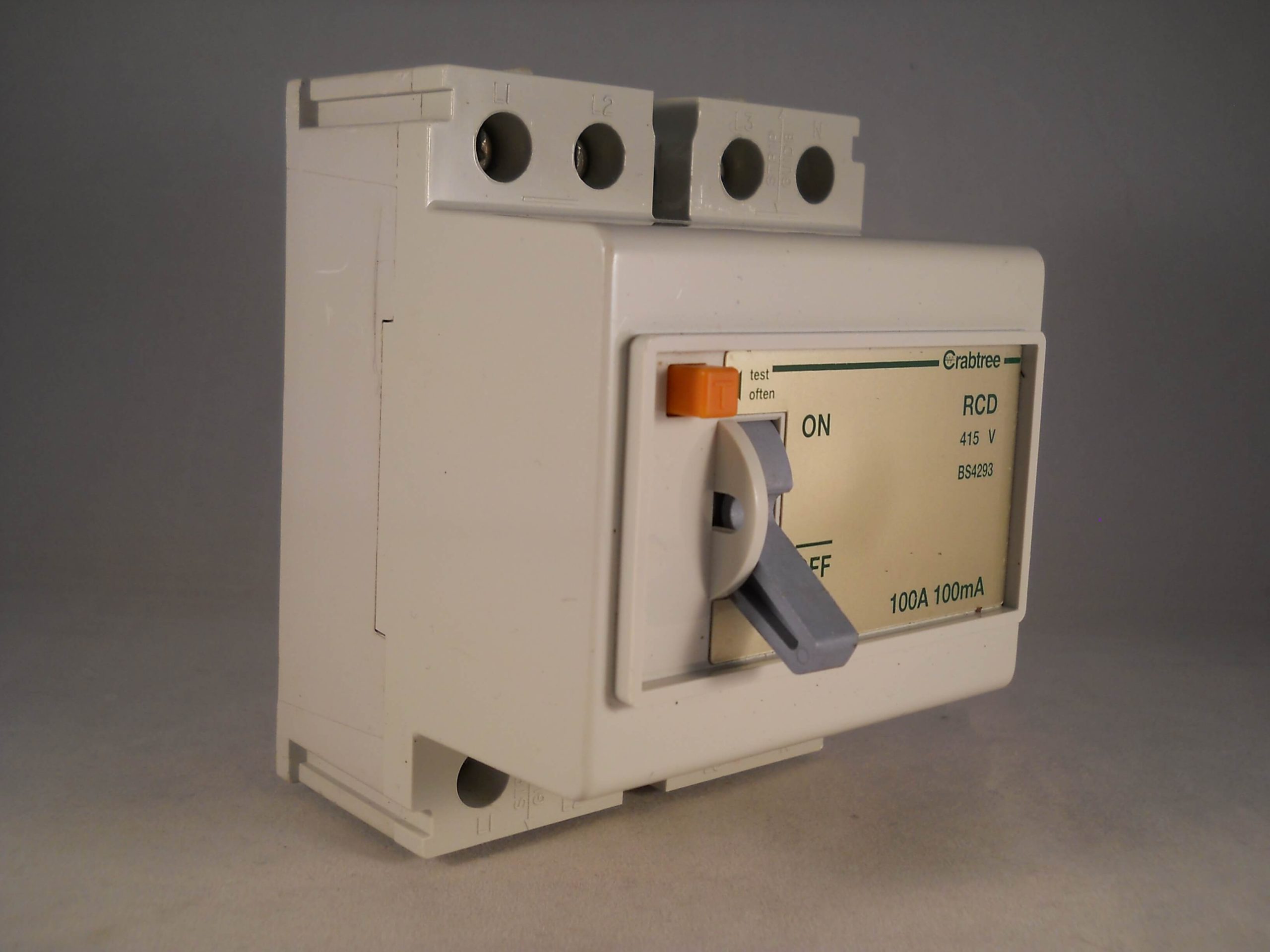

The main switch RCD is not compatible for the enclosure, pretty sure the original Polestar do not look like that plus it is wonky and doesn't fit the gap. It is also type A.
Do the EICR and do not concern yourself on how you are going to rectify things before you have the board cover off.
That make of Polestar is obsolete and RCBOs are not available, experience counts for a lot when doing EICRs.
I'm not worried about the power going off when testing as can reset it ok within a minute or so. It's just looking at the installation should there be any kind of electrical fault - even a fire this could cause the RCCB to trip and prevent access via the the gate so I'd tend to not want the Fire circuit or gate fed from the RCCB?
If I am correct the busbars have been modified to fit that RCD, I could be wrong but it is likely it is beyond repair.
As Westward10 says the purpose of an EICR is to highlight any safety issues due to non compliance with the current regs. So you assign Classification Codes to each and every item you find. Then it's up to the client what to do about that.
I wonder why a 300mA RCD why was fitted in the first place?
