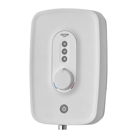

Hi all,
A few months ago we had a Triton Martinique 8.5kw shower installed. We've noticed that the temperature seemed quite low. Its what I'd consider lukewarm even when using the higher heat button and turning the heat dial up to a max of 10. The max temperature we get is 36 degrees celsius.
Does anyone know roughly what the max temperature you could expect the water to be from one of these? I couldn't find any guidance - so just want to know before I get in touch with Triton.
Also, what might cause low temps - could it possibly be a faulty TCO or something else?

Yes - its pretty much been like this since we got it. It was installed in the summer, so even though it was not hot, we put up with it. I did call Triton, and they suggested it might be something call a "Valve spindle" which is not aligned (so basically the fitter's fault if that the case)

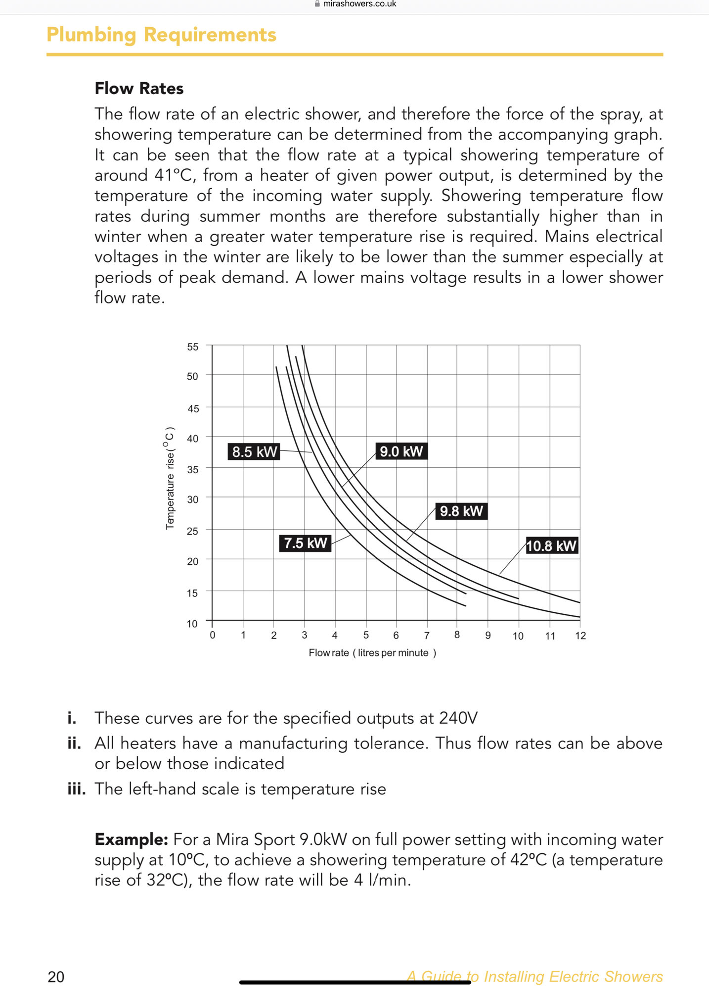

If you measure the flow rate of water from the shower head, then you can see the answer to your question on the graph below. You also will need to know the temperature of your incoming cold water, which you could measure with a thermometer at the kitchen tap.
To measure the flow rate you could, for example, collect the water from the shower head in a bucket or similar, for say 30 seconds, see how many litres you have (measuring jug, or weigh the water in the bucket!), double the number if you ran it for only half a minute, and now you have the litres/minute figure.
You can see if it more or less tallies with below. You might have more flow than you should, thus reducing the temperature (the Triton suggestion?), or there may be a problem with the heating element, or the supply cable may be long or inadequate and causing a voltage drop as suggested previously.

As it stands, the shower will only heat to 36 degrees - so about 24 degrees increase over the ambient temp of the water. The flow when turned up to the max was 3 litres per minute, and this is a 8.5kw shower. Based on the chart you provided, I'm assuming the flow rate should have been closer to 5 litres per minute?

From the graph, given the max 3L/min flow you have, the temperature is definitely much lower than it should be.
(Well, you already knew that, sorry!).
It sounds as if there might be something up with the heating element, like part of it not working? If you could get hold of a clamp ammeter, or the installing electrician has one, just checking the current the shower is taking would confirm if the element is OK. It should be drawing about 35A.
