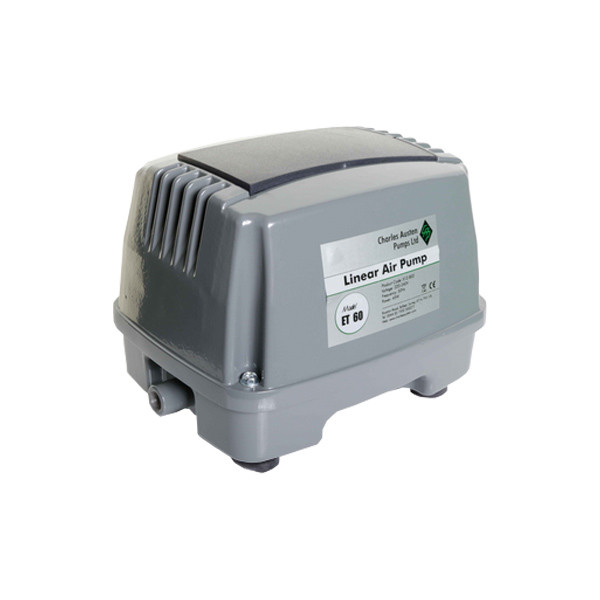

Anybody deal with these things, or is it better for customer to get the proper service engineers?
Problem is there’s an air pump that should run constantly… but isn’t. Pump feels warm to touch. There’s a 230v supply to IP rated socket, pump simply plugs in.
I might add, this is in a separate box to the septic tank… I’m not standing knee deep in waste.
All the pump does is draws in fresh air and pumps it into the main tank via a hose.
I feel all that it needs is a new pump… but might there be other parts that need looked at?
There is an amber flashing light on top of the box lid, but no where for it to plug into.
Box lid has “WPL” stamped on it as manufacturer… and the pump has its own model number.
I’ll be looking into their websites later when I get home.
Time for a specialist.
It may be that as the pump hasn't ben aerating the slurry then there's now too much for a new pump to cope with and main tank may need emptying.
The end of the air hose may be stuck in solid Sh*t and unable to blow air out.
Additionally your wandering into the territory of Environment Agency and pollution of land.
The air pumps are easy enough to get hold of.
If it is stop/starting then it sounds like a thermal cut out triggering. Disconnect the hose and see if it stays running.
It’s not running at all, Westy, but as snow head says, I’m getting into environmental pollution territory.
I’ll tell customer to get a proper service engineer in… just in case there is a more shitty blockage down the process somewhere.

Is it a diaphragm pump? Same sort of thing as a pond air pump. Could be just needs new rubber diaphragms?
