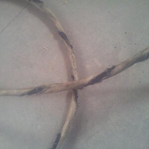

If you ever see this on an install where the earth wire has totally burnt out of the flex then proceed with extreme caution, this has been caused by a massive current melting the earth wire and is usually an external source of what the flex is supplying or controlling.
Recommended to shut off all power if you find this and do a full test on all circuits local to the issue, possible causes for this is lightning and welding rigs.
Either way this could just be touching the surface of what else has been damaged in the fixed installation, on this occasion it was a welder with a poor return path, it found an alternative route by sending 300amps down that flex and other earth wires in local circuits to return back to the welder, a loose wire on a welder cost the customer about £1000 in repairs, if you can imagine other earthing systems gets destroyed and exposed burnt live wires are possible you can understand it has caused many deaths in the industry in the past.
Had a similar one about a year ago, welding something hanging off a chain hoist .
earth clamp was not attached correctly.
it destroyed most of the fixed wiring as it was all singles in trunking, earth wire had melted itself into most of the other conductors.
they were not happy when I told them they were looking at a 2 day rewire when they thought it was just a faulty supply to the chain hoist.
