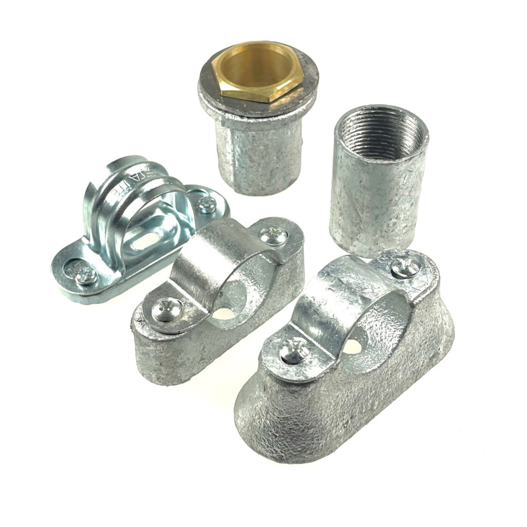

I am going to need to install a small amount of galvanised steel conduit, leading down to perhaps 4 sockets and a light switch. This is in a domestic premise. The customer wants the industrial type look and they want it looking very nice, they are happy to pay the price for this.
I have found 2 different types of wall holders and wondered if these are what are usually used, or if there are more options? Option 1 looks nicer but i don't thin it would work.

The saddles are the correct item to use, but that look a bit crude compared to the plumbing ones which, I guess, are designed for viewing but would not hold the pipe correctly.
Also the right saddle keeps the pipe at the same spacing as typical accessories like conduit junction boxes and metal-clad socket boxes, etc.
Saddles do look a bit Council Car Park , but as above they bring the conduit just enough off the call to marry up nicely to the box and they have a degree of left to right flexibility when fixed to the wall.
I think you can get online galv P-clips for pipe
Distance Saddles, or to give them their correct name Hospital Saddles, so you could clea the wall behind them.
Munson rings will be loose on the conduit.
Distance saddles and hospital saddles are not the same thing. The difference is nicely illustrated in this picture:
