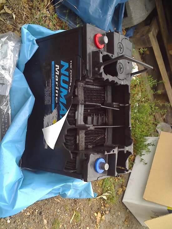

BTW that 2.7 kVA inverter's a baby compared to some of them. I regularly fit 3 kVA and 5 kVA ones, even 8 kVA on occasion. Yes 95 mm2 and 120 mm2 cable and 400A fuses are not unusual.
Wrongly installed, they can also do this 27-07-10_0951.jpg to batteries - hence my caution.
The call out message for that one said:
"Strange noise coming from the batteries and TV doesn't work. Owner wired boat himself. Slight burning smell."
