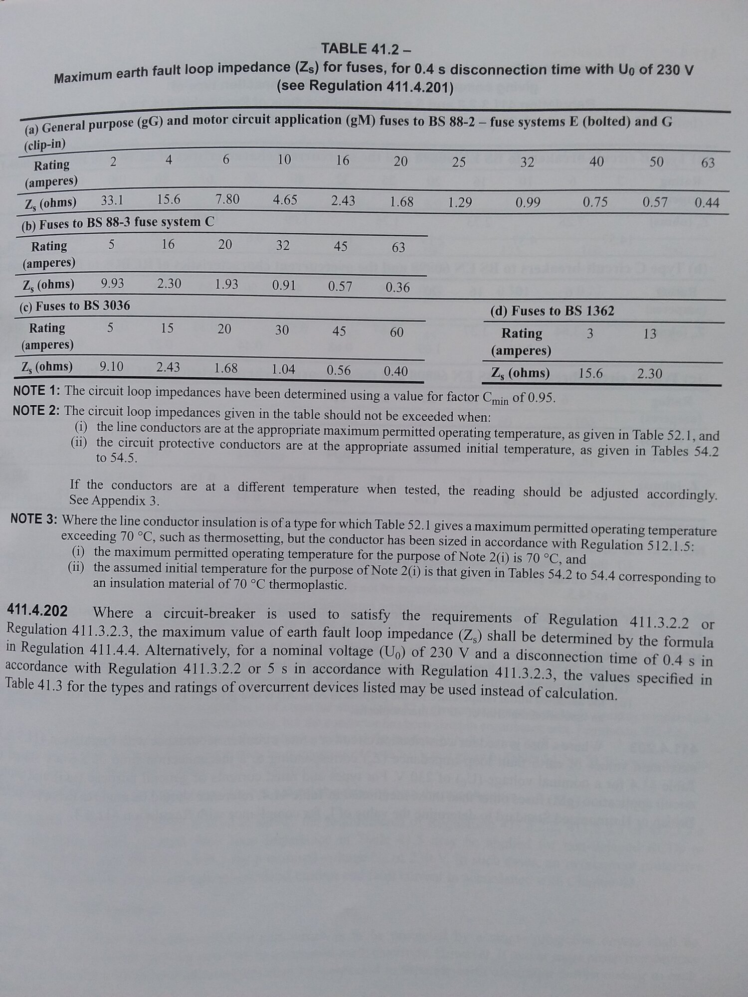

Hi can anyone point me in the right direction
I’m looking for a copy of the max zs tables for fuses/mcbs etc from 18th Ed.
I’m awaiting my regs book to arrive and need to swat up, has anyone got a link I can print out thanks
Here you go.

Hi Seems that this is an out dated question and the above would have been correct in the 17th edition. Thanks for the reply
