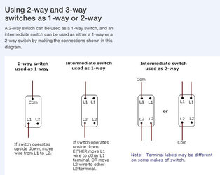

I need a 2 Gang switch with 1 x Intermediate & 1x 2 Way. I have serached a lot on the internet but had no joy!
Can anyone advise where I can find a cheap plastic one, please?

try the click modular swutches. you fit whatever switches you like into a 2 gang, 3 gang, 4 gang faceplate:
Click "Mode" i usually just buy intermediate switches and swap a module over and use 1g2w somewhere else. But you can buy the module separately as well.
The problem is I hae already fitted 2 additional switches at either end of the hallway and pulled the wires through the ceiling:sweat: and connected them all to the existing 2-Gang (2 x 2-Way) switch in the middle! and then relised that I needed an 'Intermediate switch' instead! so I need to replaces the existing switch with a 2Gang (Intermediate + 2Way) instead.
that's exactly what you can do with the click modular range. buy a 2 gang switch plus an intermediate module and swap out 1 of the switches for intermediate.
Buy those 2 and swap out the actual switch module, 1 small star screw, and then it just clicks out. Takes less than a minute.
Thank you, I ordered the switch and modules, hopefully it'll sort out the issue :thumbsup:

Click click2 Varilight even make a 2gang switch which is a 2way and an intermediate click3
