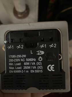

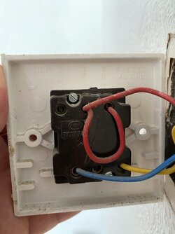

Hello,
I’m trying to change my 2 way standard on/off buttons for a 2 way 2 gang dimmer. The old cables are making me wonder where I should put in the new dimmer.
In the old 2 way standard on/off the live (red) goes into A 1 way and at the same time into B COM. The blue goes into A COM and the yellow I’m not too sure (the location is faded).
My new dimmer has ONE L and 2 squiggly line 1 and 2 squiggly line 2.
I tried putting Red into L and blue into squiggly line 1 and yellow into squiggly line 2. But when I turned off ONE dimmer one light turned off and another one.
Help???

Use both the squiggly 1 terminals for each of the yellow and blue.

I only have one of blue and one of yellow. These are for 2 separate lights in the same room.

It is an odd switch is there only one L terminal.

Do you think I should return it and find another? But my only concern is since I have only one blue and one yellow cable, won’t this be the same situation if I have 2 live?
Your old switch appears to have live in (red) which then linked across to the other switch. Yellow and blue were the outgoing lives to the lights. Does the new switch have instructions because I find just one L terminal odd assuming it isn't a smart switch.

I suggest, as I think @westward10 was saying, Red into L, yellow into sqiggle 1 left, blue into squiggle 1 right.
I don’t know how to thank you for your help!!!
I tried this and this has worked perfectly!!!
You guys are the best!!!
