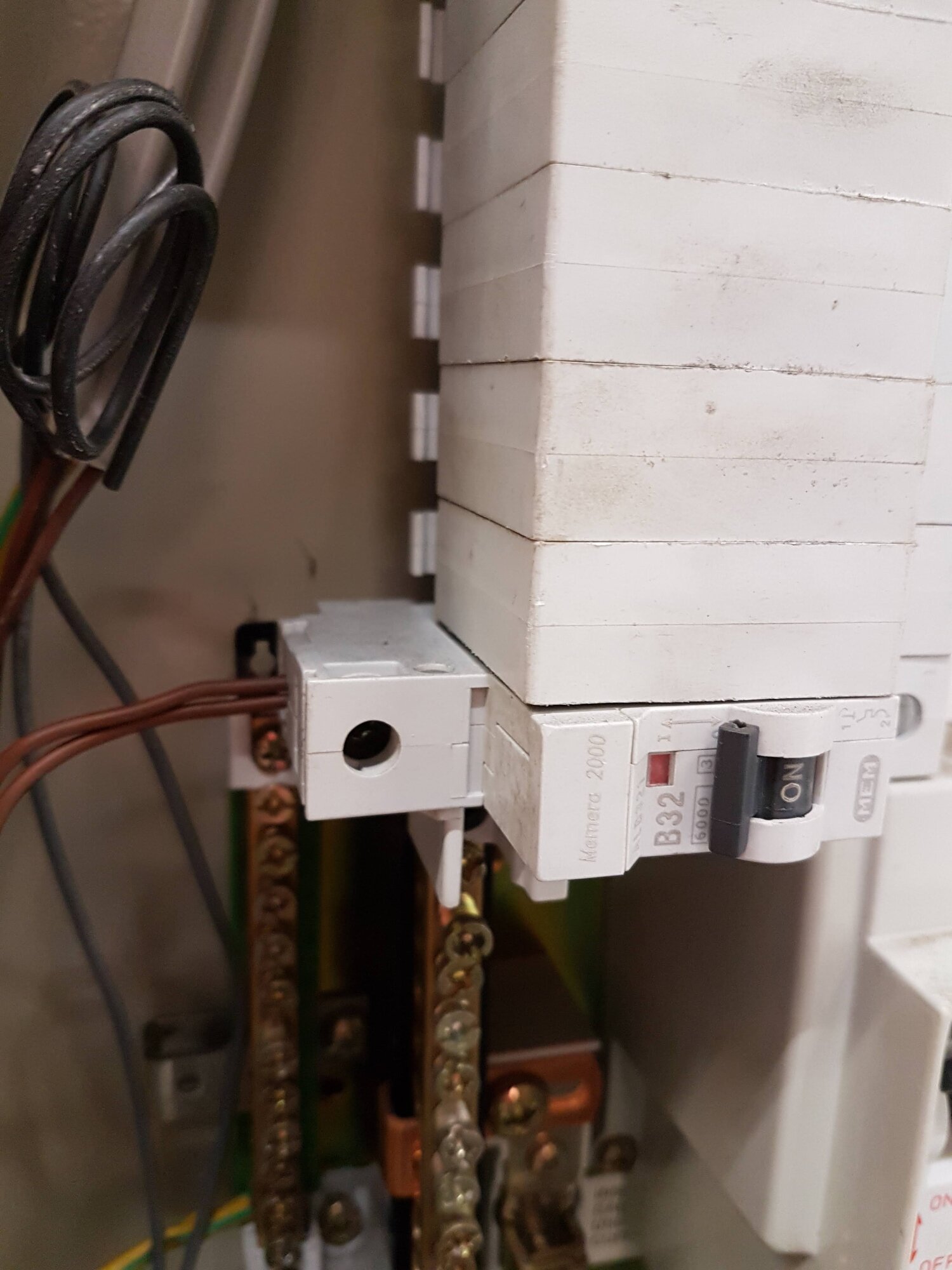

I installed my second RFC in 30 years recently. It is protected by a 20 amp mcb.The regs give a max OCPD but not a minimum. Bearing in mind that the OCPD is there to protect the wiring, reducing its size cannot cause any harm. However there is a question of possible electrical inconvenience due to the reduction in circuit size , but that is a separate matter.
This is a genuine 1.0/1.0 ring final in a factory.
