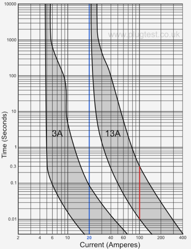

I know it can. I forget how long. Any offers from the group? I recall a 13A fuse blows at about 17A after about an hour. So for intermittent use that is fine, not for a continuous load like a space heater.
I put the large pans of cold water on each ring, then all on the highest P setting, then observed the clamp meter. No switching in and out at that point as all rings were on full belt.
If this graph is true a BS1362 13 amp fuse won't blow at all until over 20 amps and at least 2 hours.
[ElectriciansForums.net] 220v. 230v, 240v, 250v?
The characteristic curve isn't quite right or the markings are wrong, the characteristic must become asymptotic at a value no greater than 19.5A for a 13A fuse, or it wouldn't comply with the 1.5 rule going back to the 14th for close protection, and they are the same fuses now.
It could take up to 4 hours to operate of course.
Thanks Julie. I've never found a good graph for this question...
