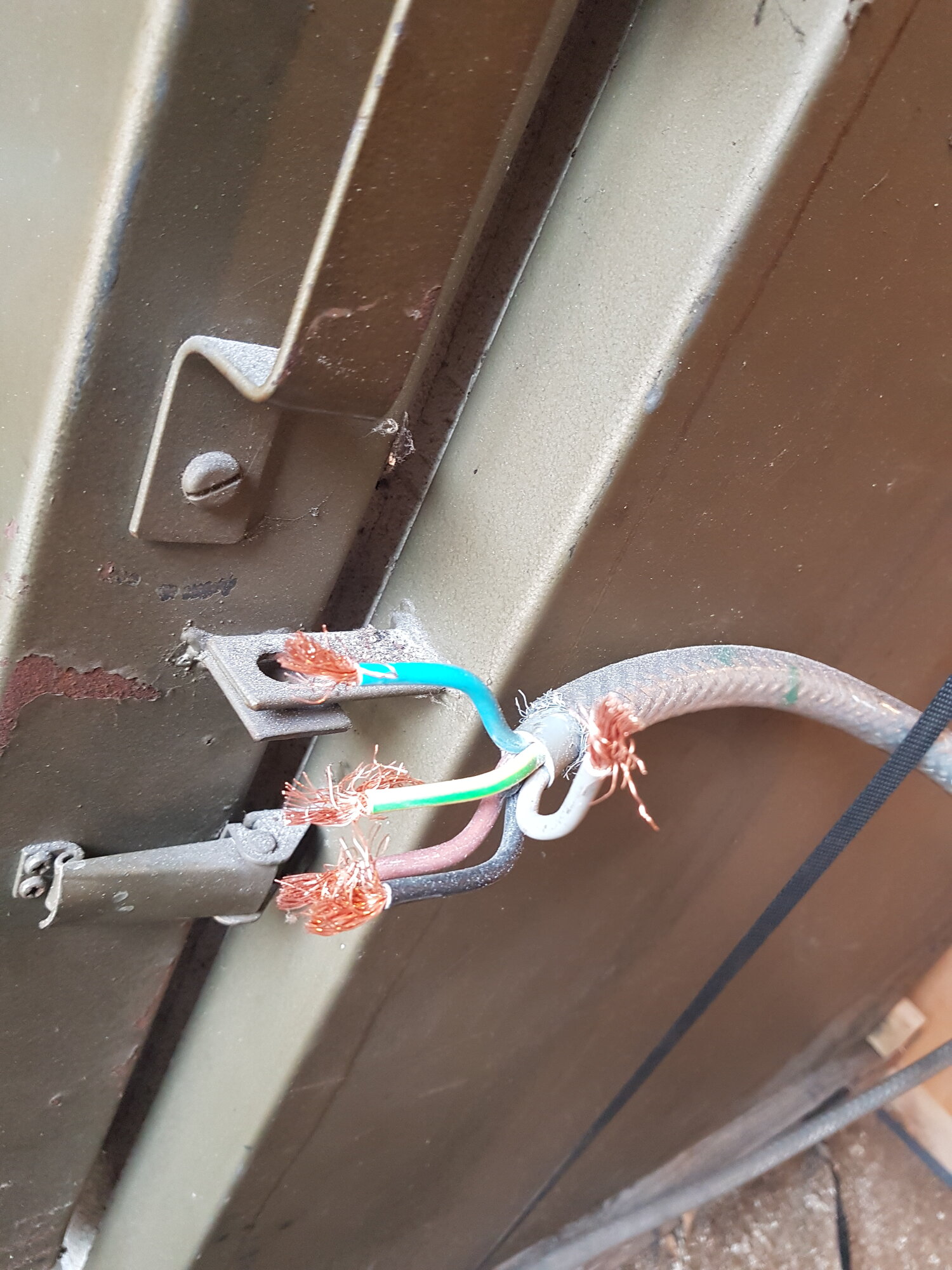

A customer has asked me to install a supply for a Wenger Webcot kiln.
The faceplate is very worn and I cannot see the kW. They state the kiln it type 3670w and is rated at 12kW.
The paperwork does have 3670w on it but when I look at the spec sheet (see picture 2, SpecSheet) ) there is no sign of a kiln which is 12kW. This model has 12 elements therefore it must be one of the last 6 models on the spec sheet, but again no sign of 3670w. It looks like there is one called 3060w though but this is not 12kW. Does anyone have any ideas how I could find the kW, or does anyone recognise the kiln details and know the kW?
The wiring diagram (see picture 4) shows that it can be wired as single phase or 3 phase. This will be wired as single phase. My questions...
1. Do I just join the 3 phases together as per the diagram?
2. Do I need to increase cable size compared to the existing flex on the Kiln as I am joining 3 x 10mm cables into one conductor? Although the neutral carries the same current and there is only 1 neutral conductor! Why is this?
3. On the spec sheet (pic 2) it has 2 columns for electricity supply required. One for single phase and one for 3 phase. The last 4 columns for single phase have a dot. looking below it says treat as nominal rating 14kW for single phase, yet the actual column labelled nominal electrical .loading states different, higher values, why is this?
Pictures below show the almost unreadable faceplate, spec sheet, cable and part of the wiring diagram.
Picture 1, faceplate.
Picture 2, Spec sheet.
Picture 3, Cable
Picture 4
