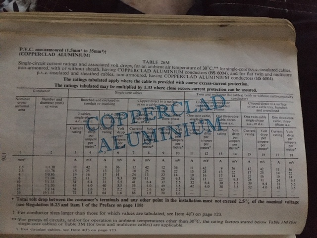

Yes, I'm wondering if they ever complied. I have a copy of 14th ed amended to 1976, there's a table of copper clad aluminium down to 1.5mm² but for plain aluminium, minimum is 16mm². I suppose it could have been different in previous amendments though.

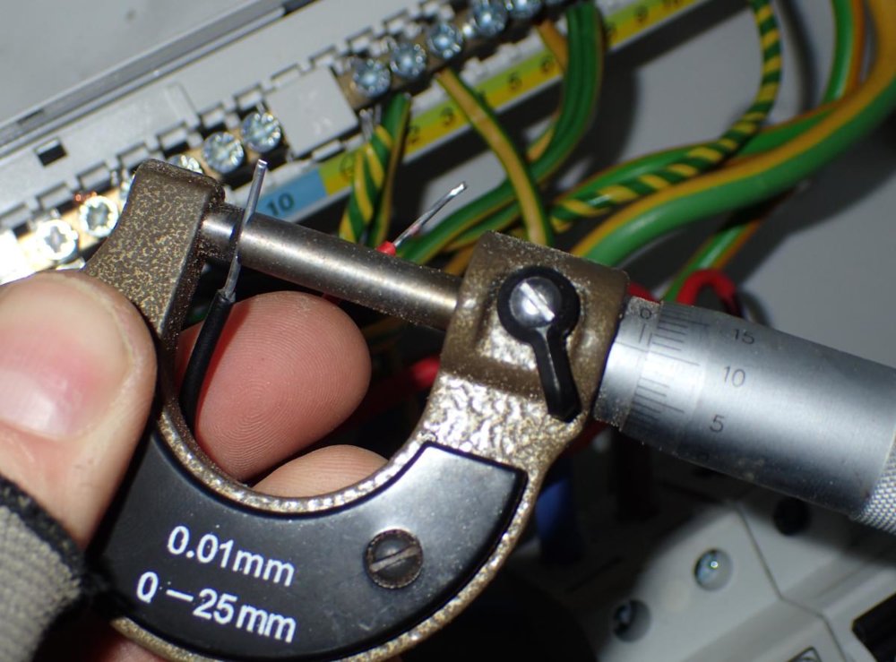

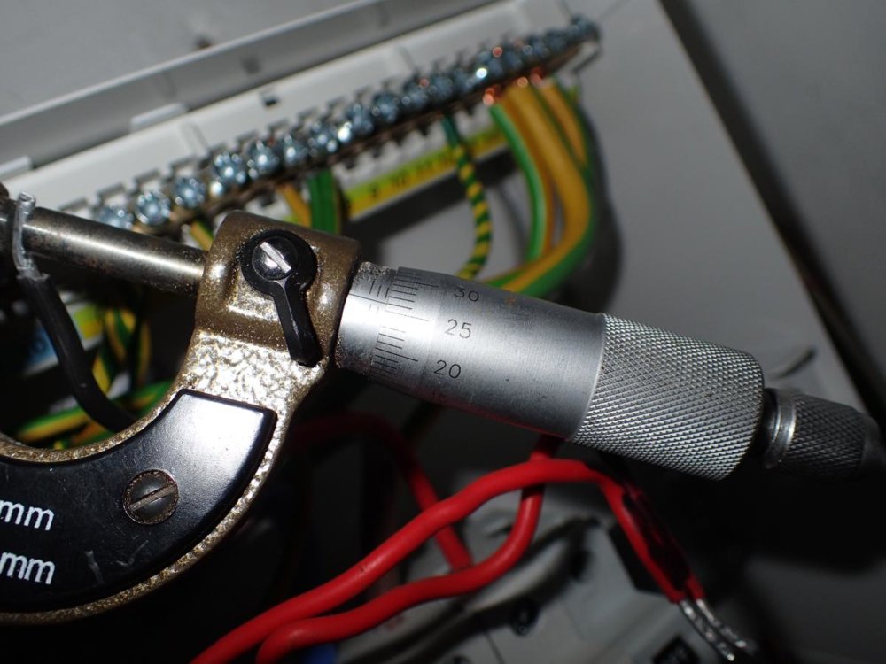

The diameter measured is 1.1mm which calculates to 0.95mm2 - so it is 1mm2

Yes, I didnt think I'd drunk that much last night but apparently my ability to read a micrometer and do simple maths had vanished.
Copper plated aluminium and aluminium cables were all around the same, plated was ever so slightly lower, I think 1.5mm2 was 11A, and 2.5mm2 was 15A - clipped direct twin and T&E hence all the rings had to be in 4mm2 which was 19A
Only MK made fittings that were suitable - they clamped the cable and could take 2x4mm2, everything else was either too small or just used a screw - the aluminium flowed, oxidised and lost proper contact.
These were removed from the 14th in the 1976 ammendment, I think it was table 24M
But the smallest used was 1.5mm2 - I think the imperial 14th which was pre '70/72 may have had smaller cables!
As has been said, it needs a rewire, sounds like the cables have reached their end of life, once they start breaking, you will be forever repairing them!
You're not far off Julie. Table 24M was removed in the amendment. Below is table 26M.
Your current ratings are for 'bunched and enclosed' copperclad. As you can see (below), they're a bit higher for clipped direct.
Also, they're for 'coarse' excess current protection. Multiply by 1.33 for 'close'.
