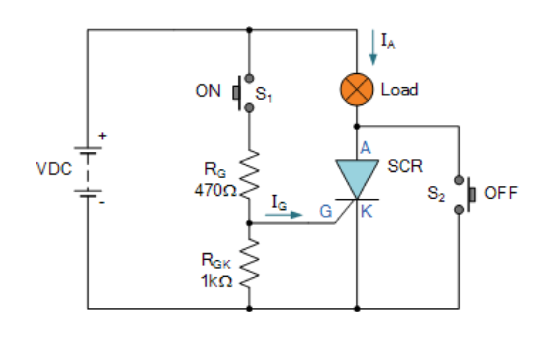

I am new here and I don't know if I'm posting in the correct place but I need some help with wiring up my Thyristor.
I have added below a photo of my thyristor.
I don't know why, but I cannot get it to work as a switch.
I will be running the gate off around 1.4v DC and I need to be able to switch around 400v DC.
I am simply trying to use it to switch off and on a 400v DC supply.
Any answers would be much appreciated!

Is the circuit switching at all ?
can you show the circuit your proposing ?
@mainline Here is the schematic. What I want is when I press S1, it should then light up LED 1. That is, if I have connected everything correctly!!! Hope this helps, and thanks for your help so far!

Still nothing. Tried reversing the LED and still no light.
When I try this schematic below, it immediately lights up when plugged in, then when I press S1 the light goes out and immediately comes back on when S1 is released.
Obviously the power to the LED (LOAD) is coming through the 1k ohm resistor going into the SCR Gate.
When I remove that resistor the LED goes out and does not come on when the switch is pressed. Also if I leave the resistor in and remove the Negative lead to pin K of SCR the LED still works without the S1 pressed.
Still can't find the issue!!!

Have you tried a resistor from the Gate to -
