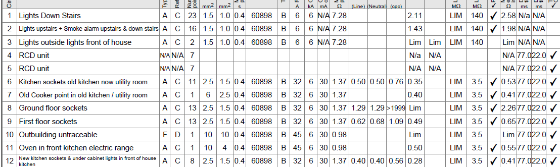

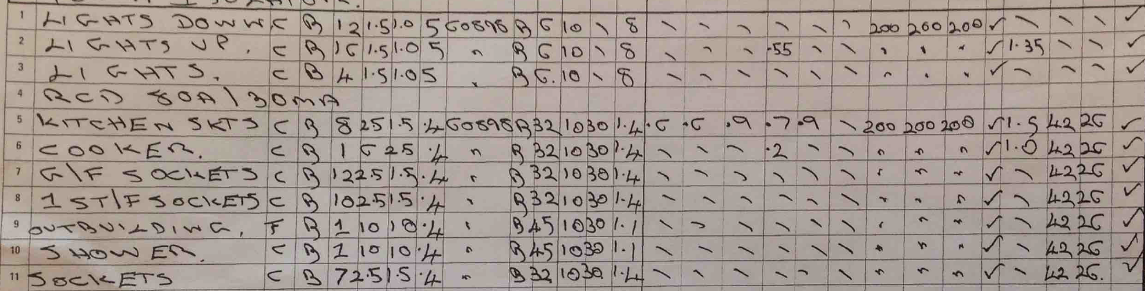

a freind buying house this is pereodic report he has I have taken a snip only | on ElectriciansForums
Discuss a freind buying house this is pereodic report he has I have taken a snip only in the Periodic Inspection Reporting & Certification area at ElectriciansForums.net

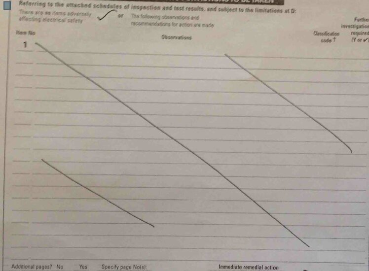

Various details missing there, which should not be missing IMO. Namely end to end values on some circuits and R1R2 values. Limitations to the testing is acceptable, but in this instance some important potential issues have not been either deduced or verified to be OK.

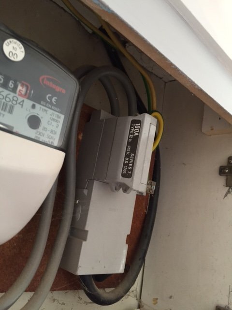

I have never completed a inspection and test of a installation without at least one observation being made (in reference to the second picture). Was there a page before the second photo that had any observations perhaps.
Who did the testing - a small or large company or one man band? And of of curiosity how much was paid.
Oh, and the Zs values should be recorded too. Poor.
5 sec. disconnection time for lights, 0.4 secs. for circuits > 32A. what a plonker.

local sparks to me, full contractor, this is from the solicitor to my friend buying the house, I said not worth paper written on, he contacted estate agent they mentioned it says satisfactory & client of theirs have paid for the test.
I am now going in Monday to do periodic for property.
I did not show the rest but least I say we have TNCS down but with a figure 0.80 for the ze inquired so says it all
5 bed house, not saying impossible but 200M ohms L/N IR testing find hard to believe myself but we shall see I will post up my results when I have done
That's some bad testing I bet the actual results are nothing like that haha.

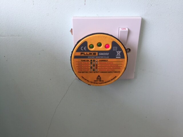

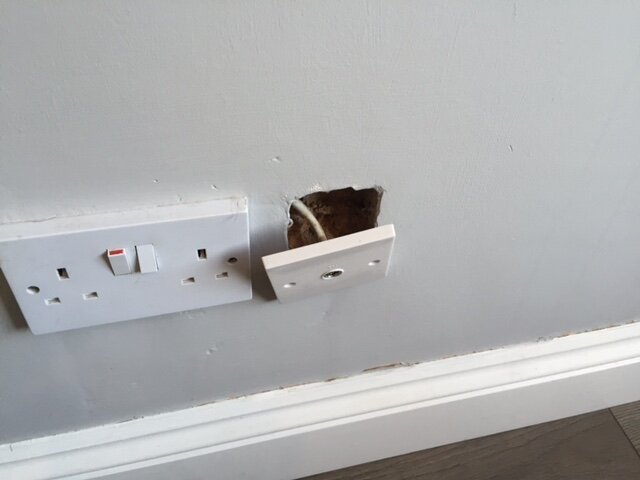

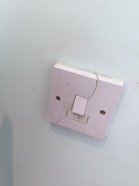

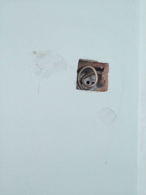

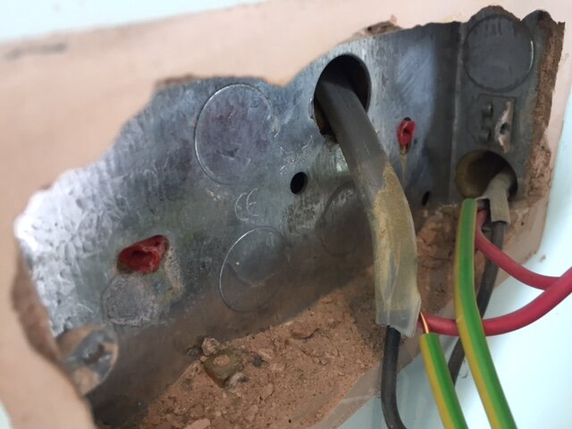

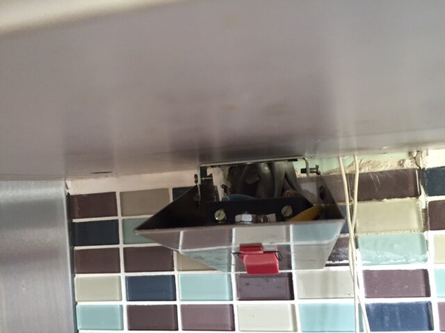

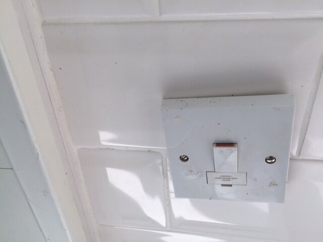

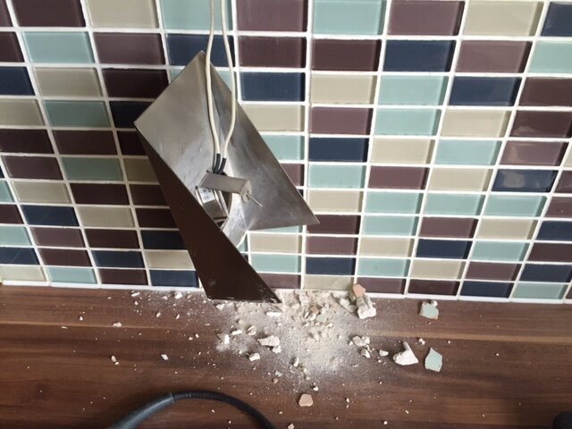

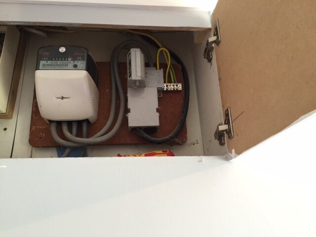

testing the above house start of the results just writing up now, just got to edit parts of cert fill in the new blanks have some other pictures will try & post.
also observations page

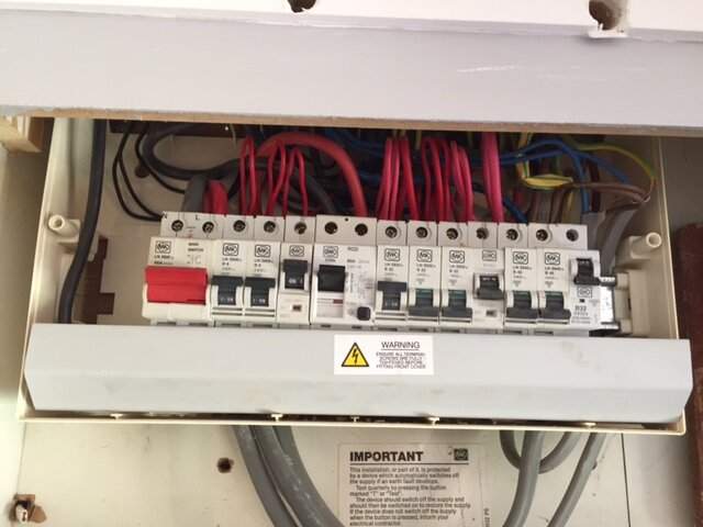

Has the cover been removed, is it TP bussbar? I fitted one as @oscar21 linked to a few months ago, it was actually a nice board and with the TP...

Twin and earth on its own isnt going to meet the requirements for burial. Why not use Swa ?
