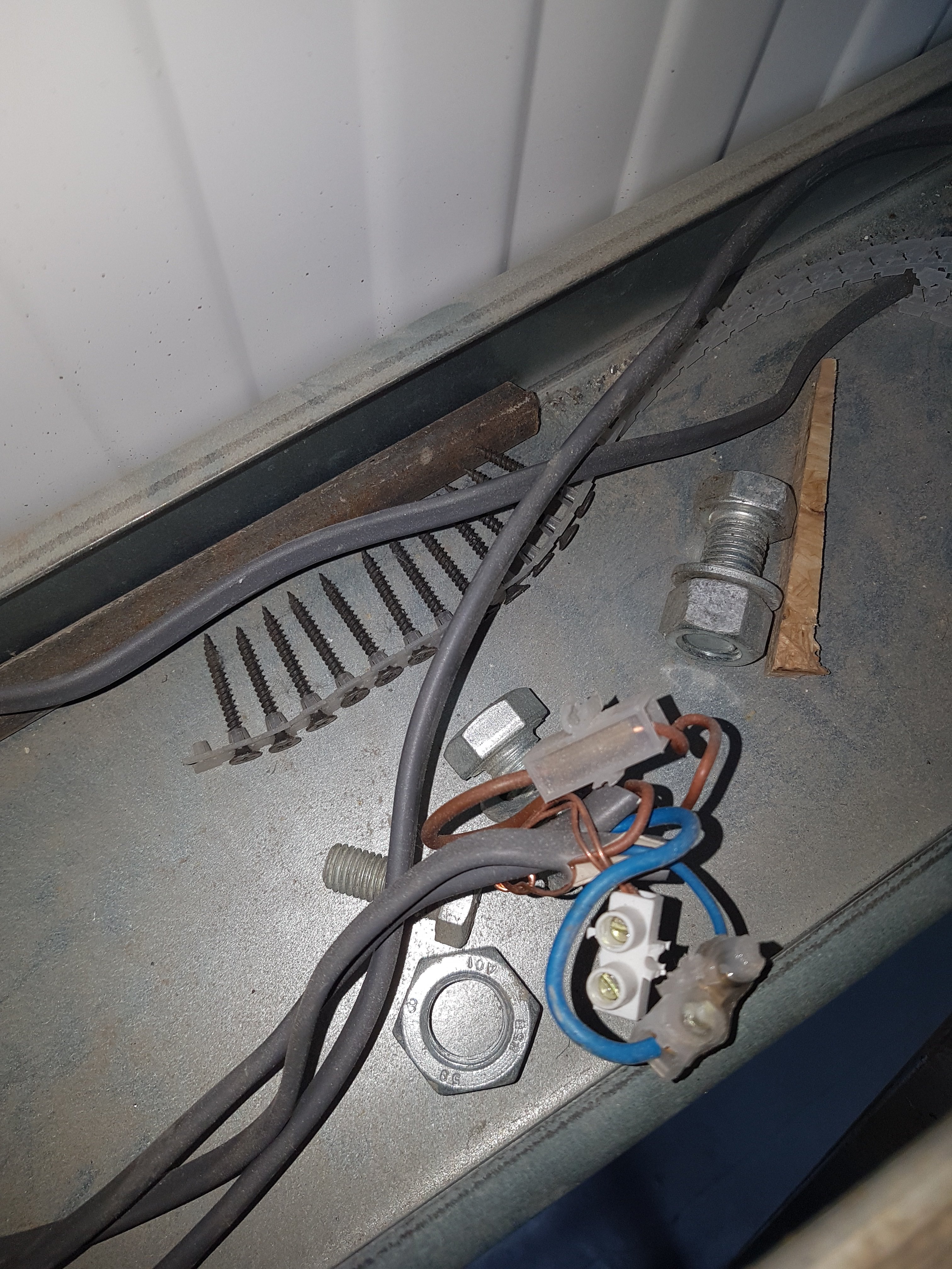

My understanding is that Building Control will accept an EICR from a SELECT or NICEIC member. I will therefore be carrying-out a very thorough EICR. No stone will be left unturned. I've agreed a deal with the client and he is happy to pay me on a time and materials basis. If the photo he sent me is indicative of the overall condition of this brand-new installation, then I dread to think what other defects I will uncover.
