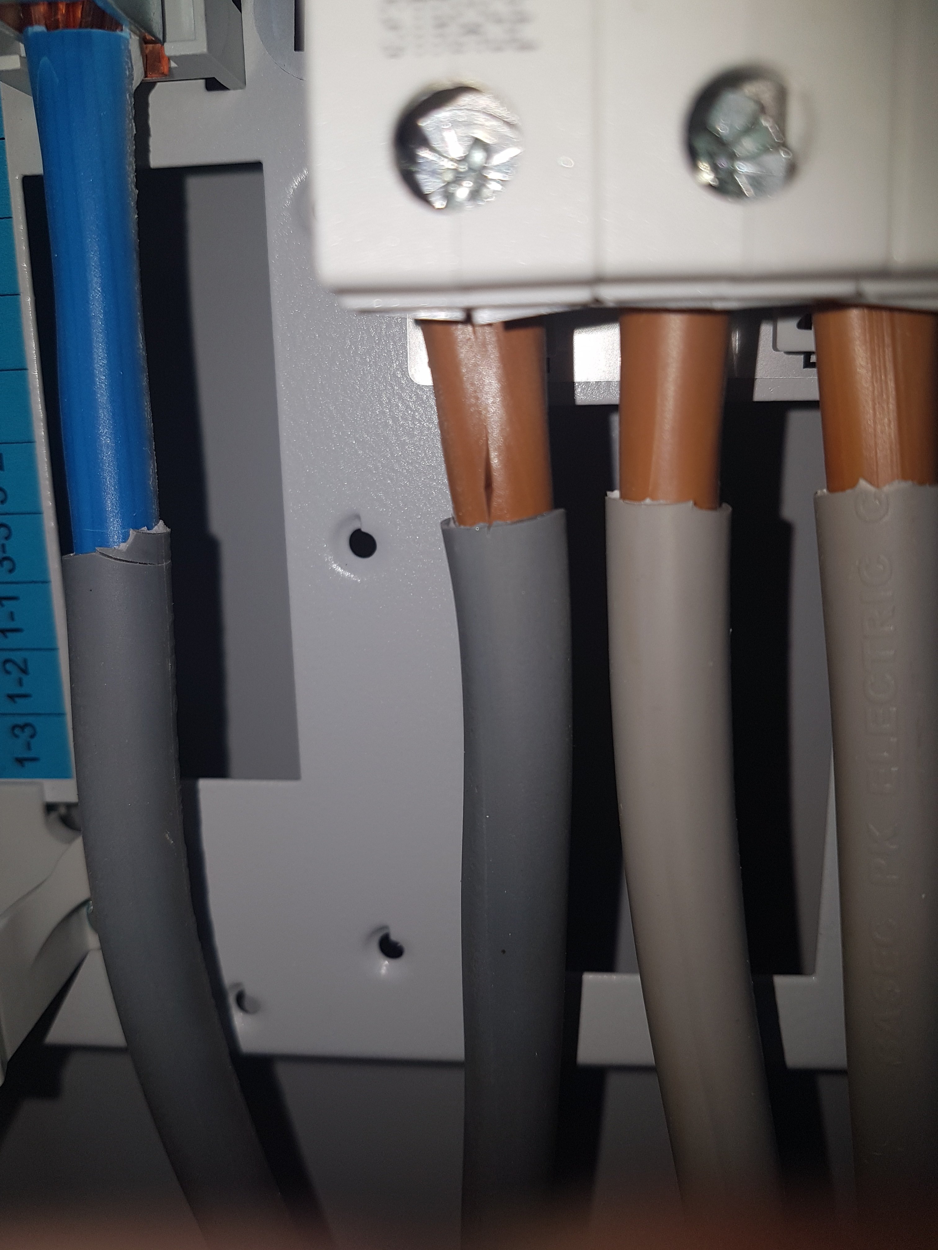

Are those terminals showing signs of "Mutilation"
by a very Peed off electrician ?
Or just some one who has a Wood butchers screwdriver kit !

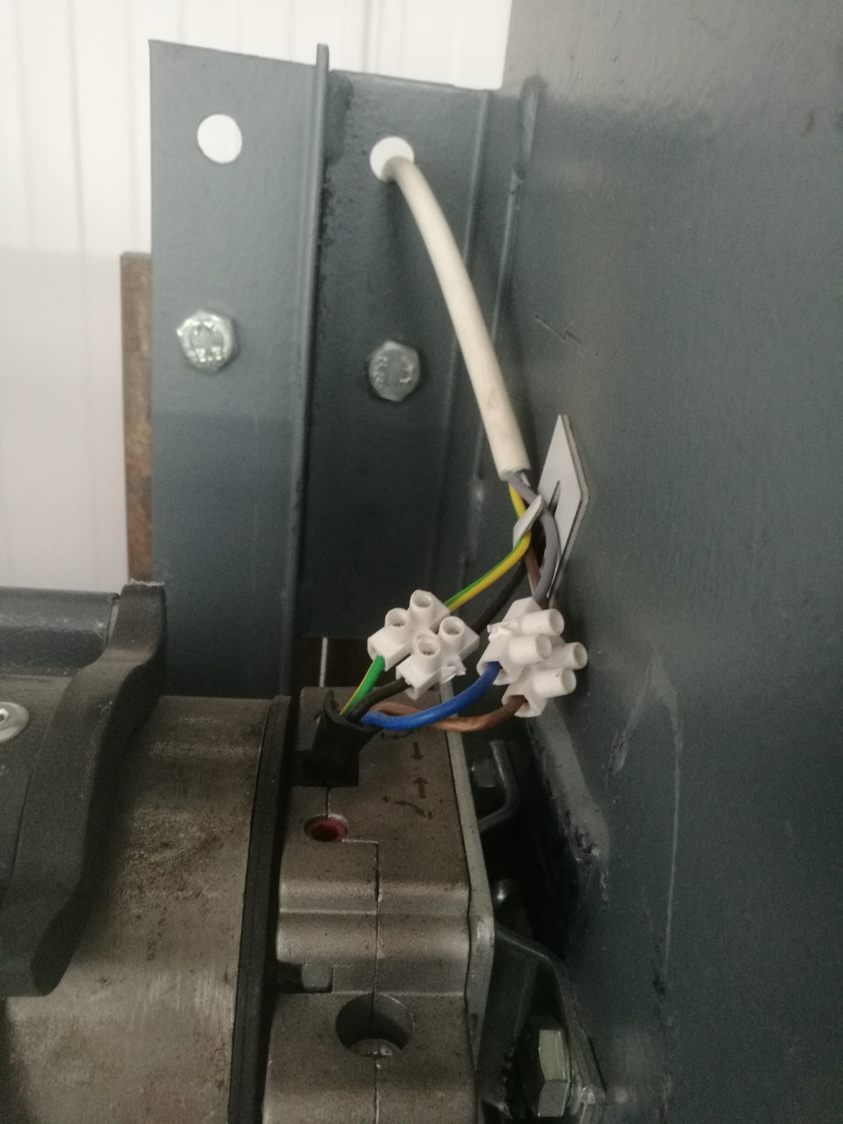

This is what wood butchering looks like.
Quite why anyone would drill this size of hole for a 1.5 mm twin and earth mystifies me. The imbecile who did this has made no attempt to seal the hole. Remember, this is a brand-new installation that someone has done an EICR on and rated as being 'satisfactory'.

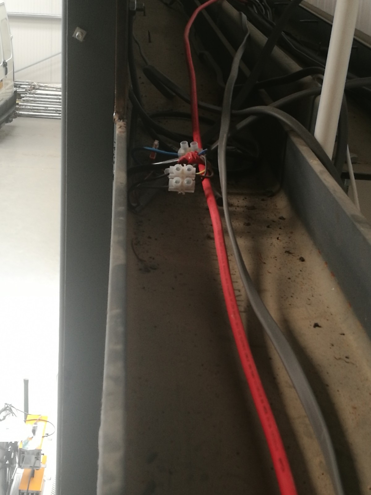

[ElectriciansForums.net] A Rather Obvious Forged EICR
This is a one of five glands that were found to be loose inside and out. The top of the gland was barely hand-tight, and as is evidenced by the photo, the bottom half wasn't fully inserted in the entry hole.
This is how the wiring looks when viewed from behind the board. All the cables have been taped together and left dangling.
