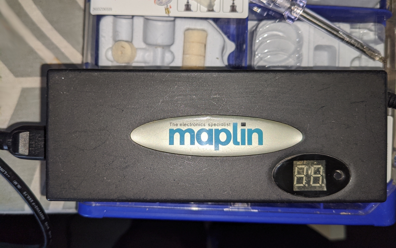

Anyway, for the nostalgic among you, I came across a "Maplins Universal Charger" (for laptops) during my sort out... Checking it carefully, its fitted with a genuine "bussmann" fuse and even the molded plug has a BS rating. I repair many chargers and laptops (just as a hobbyist mind you). This thing came with multiple plugs, can cope with a range of voltages, has a digital display and survived my sister's household (3 teenagers, 2 dogs and one husband who works in construction trade) for two years! ?
Maybe it's my old skool ways, but spending a few quid extra (sometimes) leads to considerable savings down the line...
