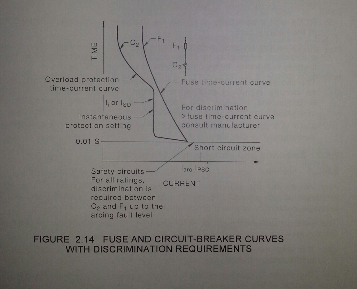

Hi Dave,
I've uploaded a figure from my AS3000, the Australian Wiring Rules. Your regs book (Big Red Book I think it's called?) or college materials should have a similar diagram. You'll need to look up what are called the time-current or inverse-time characteristic curves of the relevant protective devices.

What is the In of the type D 60898?
Have a look at Appendix 3 in BS7671, BGB. :smile:
I had this question and it was a 16A type D 60898 and I'm sire it worked out that discrimination was not achieved (but I'm not sure really) also you have to go online and find the manufacturing data for the mccb and print it off
