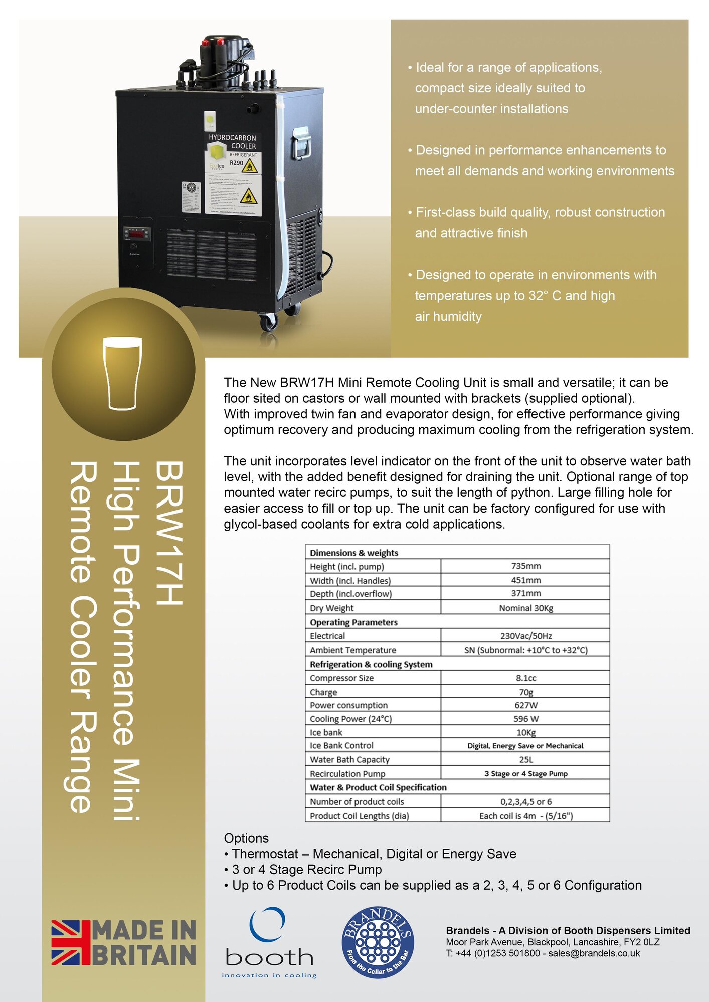

BTW I got this data sheet from the manufature of the drinks cooler
The data sheet for this beer chiller says it power consumption is 627W. The beer chiller will only work when beer is being drawn off of the beer tap.
So if we said I was to sell 100 pints a day at 30 seconds a pour would mean 50 minutes of use per day.
Which is (50mins/ 60 mins) 0.83 of an hour. X 627W = 522.5W total power consumption for this machine for one day.
So the battery in question is rated at 200AH x 12V = 2400Wh total battery life. But at a 50% discharge equates to 1200Wh battery power
1200W/ 522.5 = 2.30 days before the battery needs charging.
With out doing the maths or anything. Dose this sound about right for a load of this kind on a battery of this size?
Thanks
