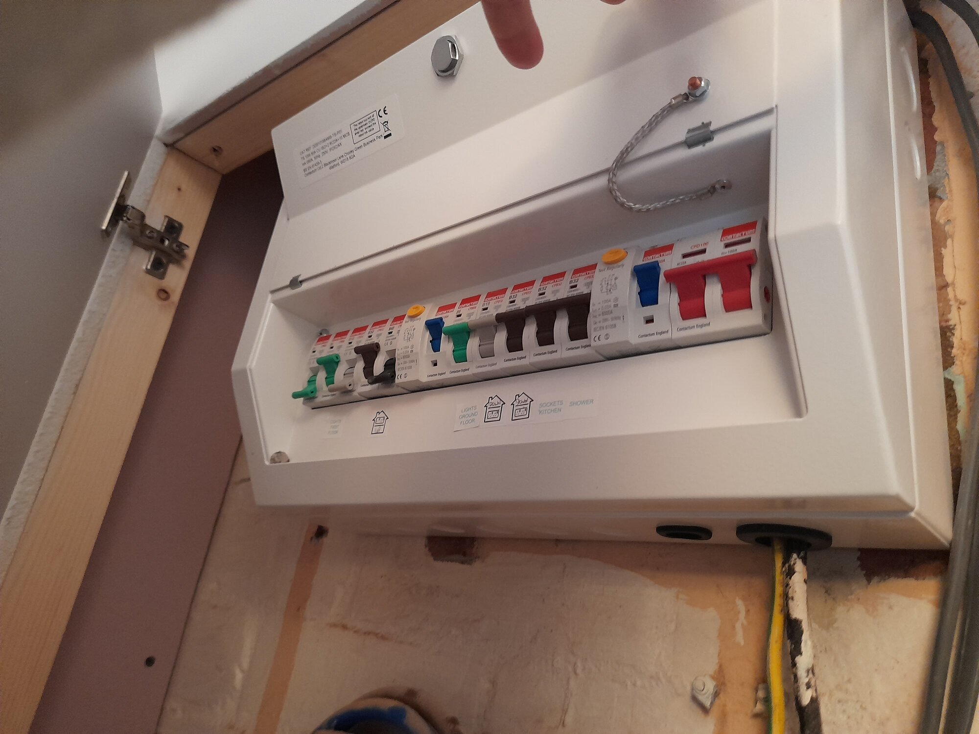

Photograph of the consumer unit that the report corresponds to would be good.
The rcd time column should be filled in with the measured time displayed on a specialist RCD test device, which will be measured in milliseconds…. And should be less than 40ms.
Had to google what a consumer unit is, complete novice here.
Can try and get a better picture later my partners home and can assist, not much room between the hatch and Fridge Freezer and is difficult trying one handed whilst holding open the flap for the unit.
Apologies, I have no understanding of the RCD portion of your reply.
