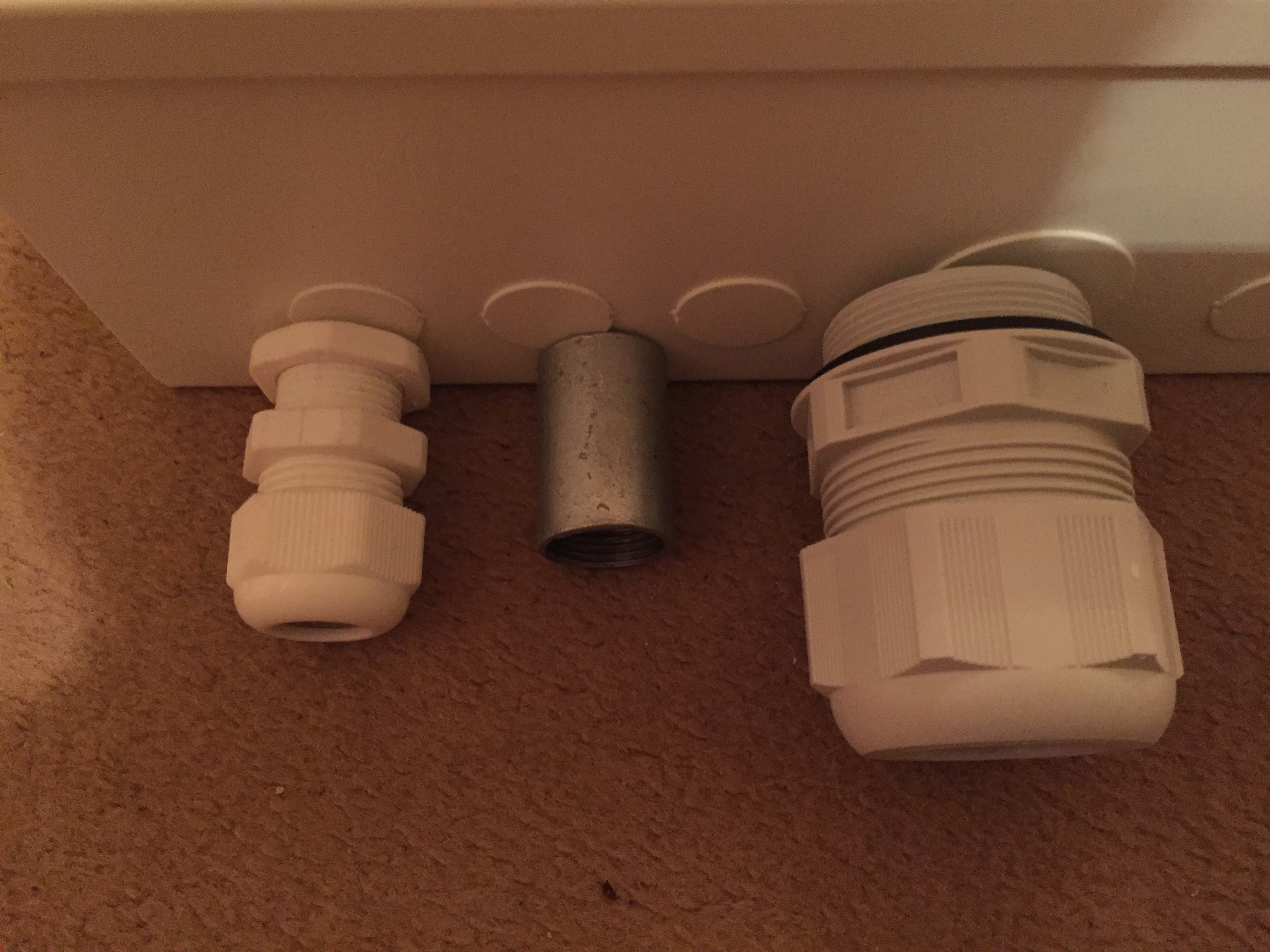

I seem to have a run of jobs of upgrading consumer units. Previously I've used 32mm standard stuffing glands for the tails when I have needed to. Although the sealing gland hasn't got specific holes for the tails i find that it seals well.
Anyway I've been looking at the special tails stuffing glands. My wholesaler is quoting alot for the metal wiska type. Looking at screwfix they have 2 plastic types. One is just the gland and one is a kit with a KEM adapter.
The only problem is that they need a 40mm hole and on the wylex boards I'm using have 20/32mm holes. So i would have to enlarge the holes to suit or buy the kit with the KEM adapter. Just wondering if anyone has any experience of these?
Just not sure because they seem massive in size any other suggestions what other people use ?
Cheers

Been meaning to load these for a few days I put the tails gland agenst the board to see for size. There's a 20mm stuffer and 20mm coupler just for size reference. The tails gland is massive so that is being sent back and I'm going to go for a 32mm stuffer for the tails.
[ElectriciansForums.net] AM3 Tails Stuffing gland
But you wouldn't get 2x 16mm tails in a 20mm stuffer would you? And if the tails are 25mm?
The only issue with the bigger gland is cutting the damn hole. But the bolt up plate cutters make quick work of it.
