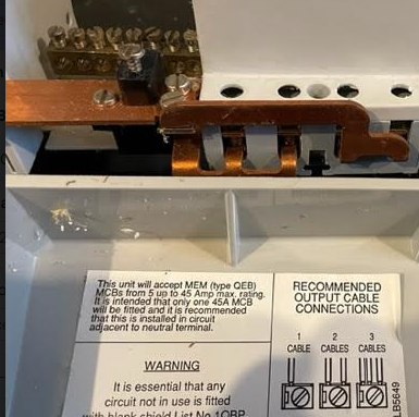

Quite old main switch RCD, it occasionally trips (every day or two), then won't turn on until all breakers are off.
Ramp test at time of testing was 25ma, earth leakage meter said 5ma (so consistent).
Is the RCD likely to simply be old?! Are they tetchy switching on under load?
Haven't got into IR testing yet. Their initial enquiry was for a CU change so a DP RCBO board will likely solve all issues or worst case show up anything that has intermittent faults.

Not familiar with that old incomer and didn't want to assume busbar connection to it, but lettering appeared to show 'L' above left terminal.
I had a look this morning. I have to say, MEM made it about as idiot proof as possible!
[ElectriciansForums.net] Any thoughts on this old thing?
Even told us how to put wires in it!
