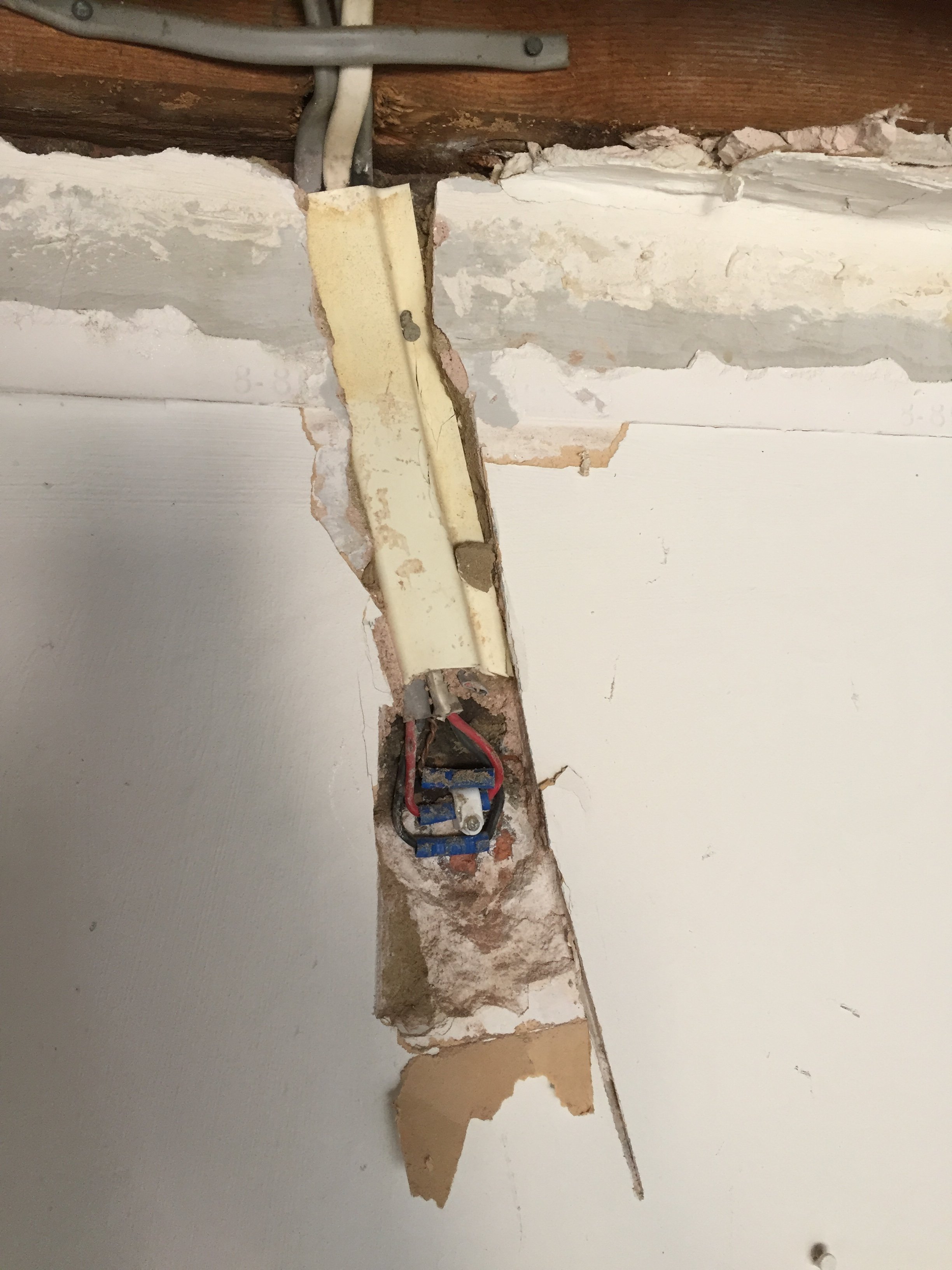

The Guy who was the electrical Manager was a tight fisted so and so, he would not supply us qith cable clips, we had to use cable off cuts and plaster board nail to make our own, they won't be seen so whats the problem was his answer.
Fitting Ceiling Roses and Batten Holders, he had another trick, he supplied us with 1 1/2 no6 screws for this task, the only stipulation was use 1 and push a plaster board nail on the other side, so each ceiling fitting had 1 screw and 1 nail as fixings, why did you put up with that? you may well ask. Whilst I don't condone this type of thing, when you had a new Wife and Baby as well as a Mortgage you did as you were told, I lasted about 9 months, anyone else got any horrors, or are the frightened to say? there is no statute of limitation mind you.

Ha ha, I do very little domestic work, but I have seen this a couple of times and it always made me chuckle.
What didn't make me chuckle was coming across old switchgear that was held up with a bloody 6" flathead rusty screw, I hope that wasn't you @Pete999 :)

I experienced my boss sleeving up a cpc in a piece of twin and earth to make a two way circuit an easier option with less chopping out of walls. Now that is a class act of 1980's disregard of the 15th Edition.

Cut clasp nails to fix back boxes :)
Hi. I know this happened all the time on new builds when I was working. It was easy to hammer a cut nail into the soft blocks and it was quick.
If the cut nail was sharp I can see where the problem lies, but mostly they are rounded.
The main problem I can see is if the back box is needed to be removed in the future, a boxed which is rawl-plugged and screwed is easier to remove. But, if the box is plastered into the wall then a mess will be required to remove either fixing method.
Or am I missing something?
This isnt a pop, I am keen to learn.

Might of been easy back then, but its a right pain in the bum to get them out now, back boxes with cut clasp nail that is :D
