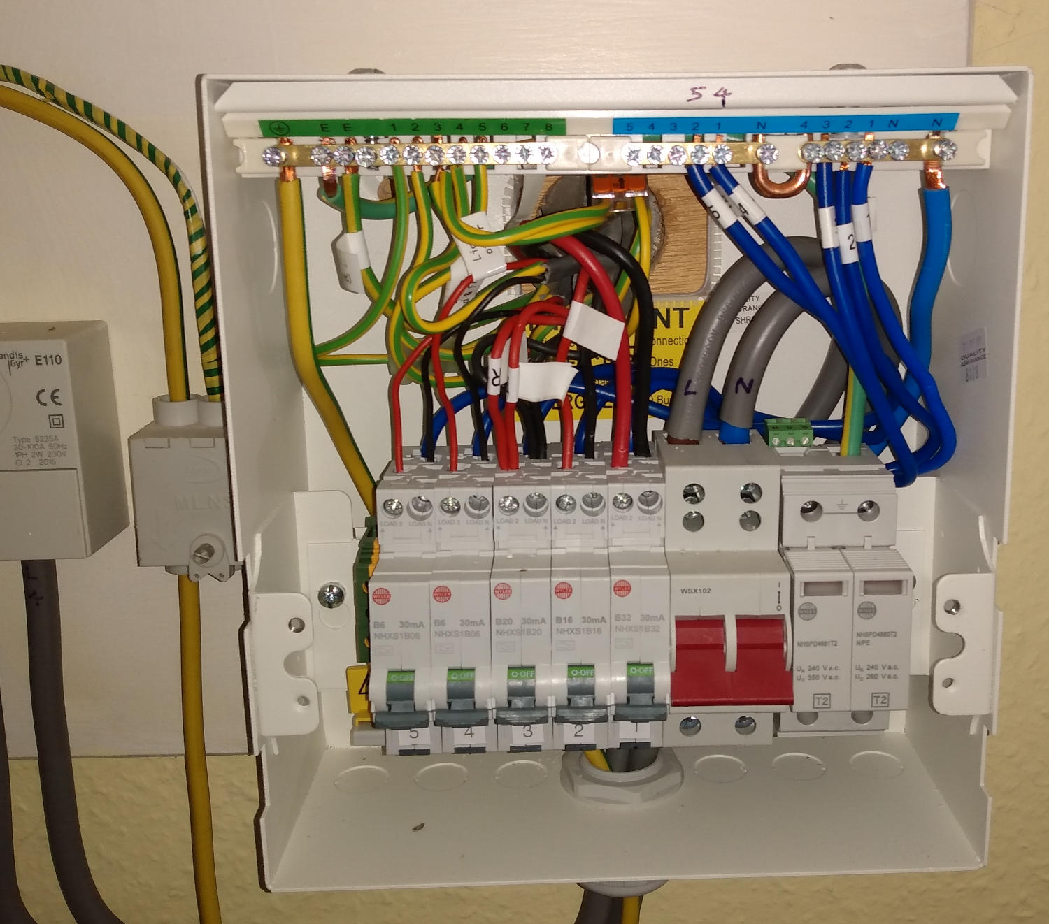

OK that is not what I have used, here is the NHSPN00111L recently done:
And from a year or two back the NM606FLEXS (suspect that part is changed as now single-module SPD):
