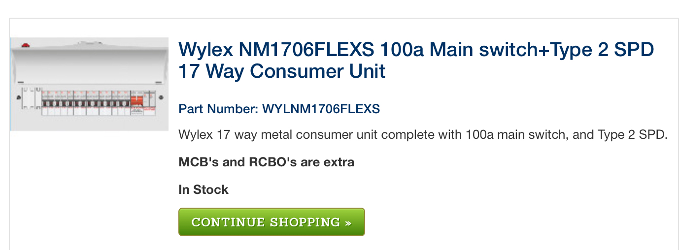

The new Wylex are solid boards
This would be my thought, using the new Type A RCBO with switched L and N :) .
