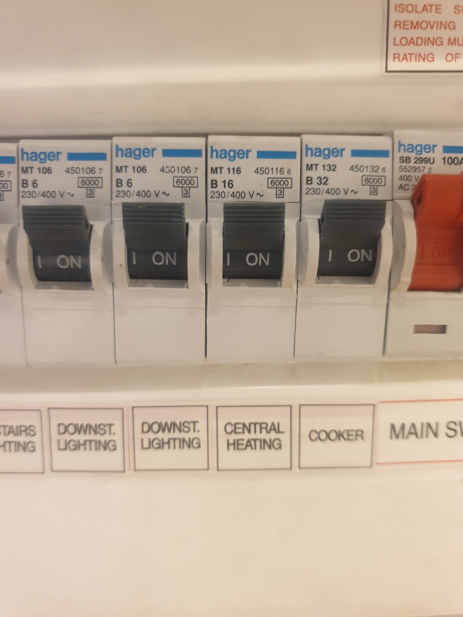

Sorry If I added confusion. The potential issue is just how much current the switch is designed to handle. Not so much about whether the boiler will overload it, more whether the regs allows a 10amp switch on a supply that is potentially fused higher.
Do you know which circuit breaker or Fuse isolates the boiler at your consumer unit? Does it have it's own breaker or Fuse or is it part of a plug sockets circuit?
We don't have that information. If so, I agree absolutely no problem. But the boiler spur might equally be on a 16A radial or on the RFC.
Do you know which circuit breaker or Fuse isolates the boiler at your consumer unit? Does it have it's own breaker or Fuse or is it part of a plug sockets circuit?m
It has one on the circuit breaker picture attached
My view having read up a little on this is that it's fine to use that switch. Apologies for distracting the thread by querying this. I like to know why things that feel like they ought to be allowed are actually allowed....
Reg 537.3.2.2 "When a switch is provided for this purpose [isolation for maintenance] is shall be capable of cutting off the full load current of the relevant part of the installation."
The full load-current would be the boiler current draw - control circuity, pump and fan. Should be nowhere near 10 amps.
