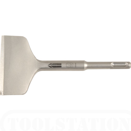

I use the SDS on roto stop and a Bosch spade chisel (dont be tempted to buy a cheaper version as they just snap) for boxes and chases although this has now been superseeded buy A Heller brick removal tool from Toolstation. I initially bought this for removing a chimney breast at home but is GREAT for boxes and chases.
.toolstation.com/shop/Power+Tool+Accessories/Chisels/SDS+Plus+Mortar+Chisel+6+x+250mm/d80/sd2781/p39281
