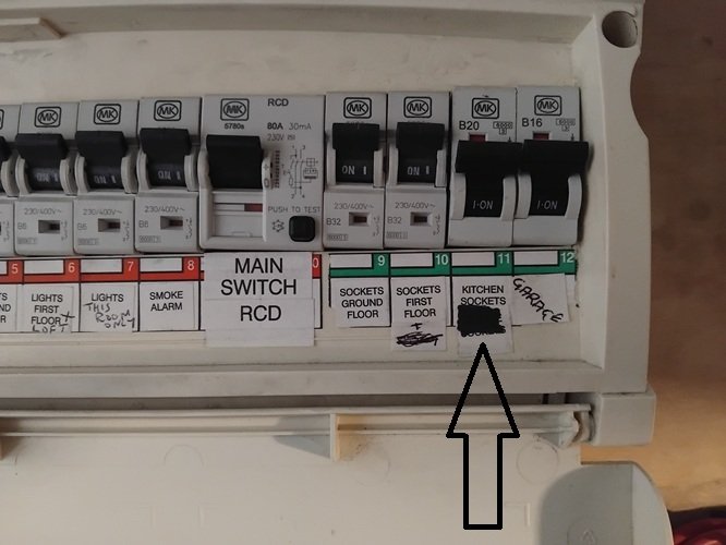

I have only a simple multi meter at my disposal so how would I do as you suggest?
I was hoping to work out where the possible break is without having to go to the CU and disconnect wires but if I disconnect one of the two brown wires in the RCD and then go round the sockets with my socket tester, I can ascertain which one are on each leg.
I can't imagine where 2 brown wires would be in an (RCD) Residual Current Device,maybe you mean mcb or rcbo?
If it's wired as 2 radials there will be a socket with only 1 cable there would most likely be 2 of these.

It's a 16th edition MK consumer unit and the kitchen sockets are protected by a circuit breaker in the RCD section of the CU as shown below

Honestly, just get an electrician in.
They will 'probably' find and fix it in 2 - 3 hours (cost £120 - £175).
They'll do it safely and correctly and save you a day or 2 of phaffing around.
This also saves you playing around inside the consumer unit which really is dangerous.
